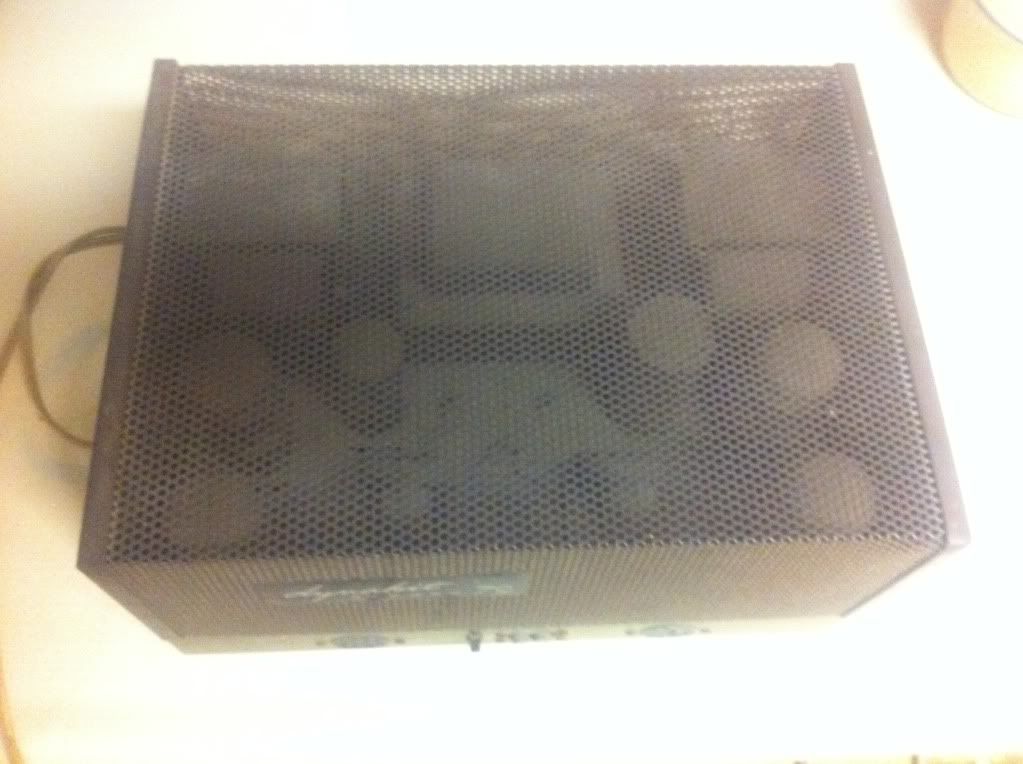

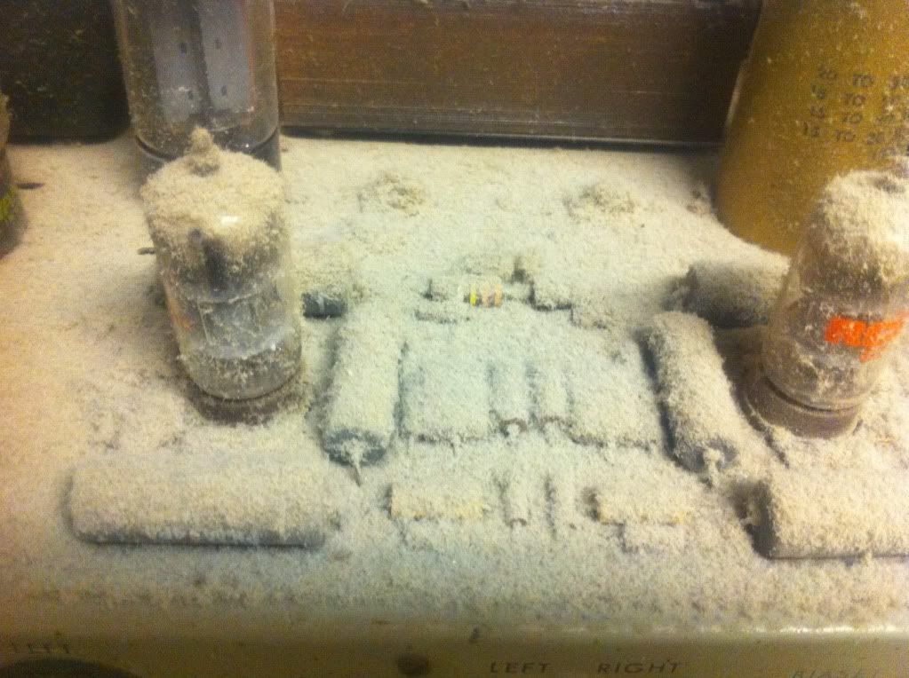

    Here is my second Dynaco ST-70 that I picked up a few weeks ago. I am going to do a rebuild on it.
    Here it is with the cover off. It had about 1/4" of dust on it!

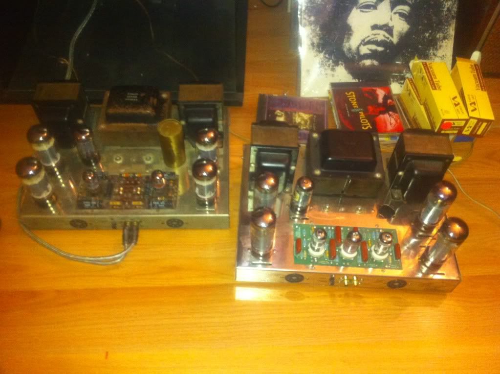

    Here's a pic next to my othe ST-70 before I stripped it down to the chassis
    I stripped it down to the Chassis and cleaned off all the rust and corrosion and I am painting the transformers now.

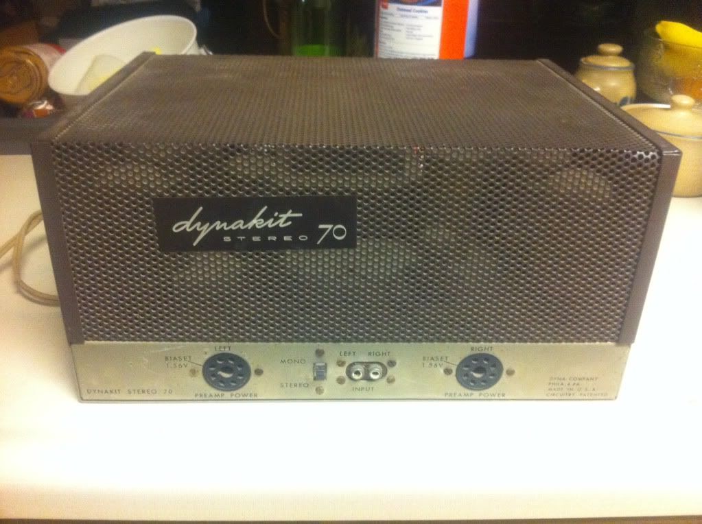

    Nice job ... I love seeing Dynaco amps rescued from the scrap heap and redone. When you are done you should post a photo of the completed rebuild right next to the photo of yours below which shows the amp under a heavy layer of dust. Take the photo of the completed rebuild from the same angle as the photo below ...
