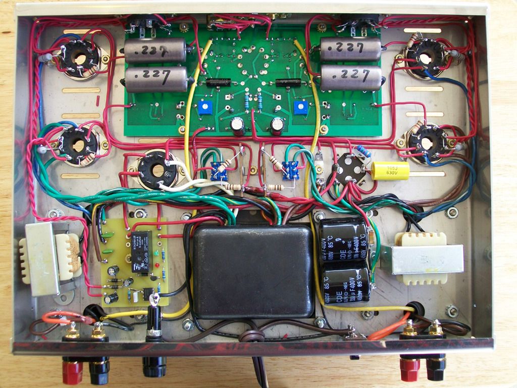

    Post by Bob Latino on Sun Feb 12, 2012 9:57 pm
    Below is what a VTA ST-120 wiring job should look like. This one was done by Sal Brisindi. Nice job, Sal .. If you want some quality work or repairs done on your tube amp send a PM through the forum here to member "Sal"

    Post by Sal on Mon Feb 13, 2012 12:50 am
    Thanks for the compliment Bob. I can't believe that messy wiring job, there is enough wire under that chassis to wire 5 tube amps...
    BTW, what was the problem with that amp? Must have been fun tracing all those wires. Did that amp pick up any radio stations with all that extra wire acting as an antenna.. Shocked

    It must have been difficult to make such a mess as that. I do notice however that on the contact strip he used two smaller green caps instead of the larger yellow types and that is the only thing I can see that makes a little sense.
    Bob you have a sense of humor I like by publishing these crazy projects I recall the crusty amp and a few others.
    Sal: YOU ARE A MASTER!

    I was going to award Sal's job as the tidiest, until I saw a stray bit of red wire between the left two output tube sockets. Now it's a tie! lol!

    Post by Sal on Tue Feb 14, 2012 4:56 pm
    Thanks,
    I just noticed another one between the line cord and on/off switch... damn.... now I have to take the picture over again.... sorry for being sloppy, I'll try to be neater next time Very Happy
    Sal

    ... and while we're nit picking, that transformery thing on the bottom left . . . is that a choke? Well, for Pete's sake, it's crooked! Throws the symetry of the whole thing off for me.

    This is like solving a puzzle - spotting Sal's miscues! Well, I think I have spotted another - if you look very closely at the bottom left corner, there appears to be miniscule piece of red wire, just below the brown wire loop.

    Post by Sal on Tue Feb 14, 2012 6:20 pm
    The mounting of the choke on the left is using the existing screw that holds down the left audio transformer so the choke is on a slight angle.
    You are correct Captain, now its 3 pieces of insulation I forgot to take out.. I feel so ashamed...

    Probably stray bits of stripped insulation rather than actual wire. The reason the choke is skewed is because of the mounting hole position which allows the choke to contact the side of the chassis (also notice there can be only one mounting screw). Understandable considering this is a modification (with dual chokes) using the original factory-standard chassis design.

    A hah! Then we all have chokes that are equally wonky at best, which in a way, restores symmetry!

    I almost hate to say this because it's so pretty, but...
    I actually have a beef with the wiring, Sal- when I learned amp building, I learned that the first thing you would wire up were the heaters, and they should be down in the corners of the chassis. This puts the AC wires in the most shielded position, and the other wiring can be easily moved away from it should there be any noise issue.
    Maybe it makes little or no difference in these particular amps, but you know we're always trying to do things ever better!
    Using solid wire really lets you bend and place them exactly the way you want; nice!

    Post by Bob Latino on Thu Feb 16, 2012 8:32 am
    As long as you TWIST AC heater wires, you won't get any noise issues with these amps. Twisting AC heater wires will insure that both wires of the pair are at right angles to each other at all times and the fields will cancel. Other general wiring paractices are that everytime you cross a twisted heater wire pair with another wire, try to do it at right angles to the twisted pair - don't run another wire right "beside" a twisted pair if you can help it.

    Post by baddog1946 on Thu Feb 16, 2012 9:18 am
    Hi Sal:
    Let me say that's one nicely wired amp kit you did there. I have gotten a few tips from it for the customized amps I am working on with aluminum chassis. In fact I printed a copy of it and have it on the wall at my bench as an example to inspire and remind me to take my time and do it right.
    The only thing I can see that could be done to it is to remove the extra pins on the octal bias sockets.
    I did this on a kit and it left a little more room and looked a bit tidier but you have succeeded in making a real gem there and I offer this humble suggestion with the respect you deserve here. Good work!
    p.s. What is the value of the single yellow cap you used in place of the piggy back version more commonly seen in the kit version?
