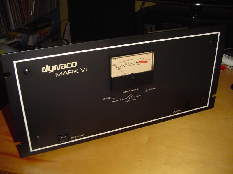

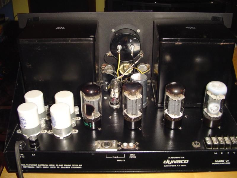

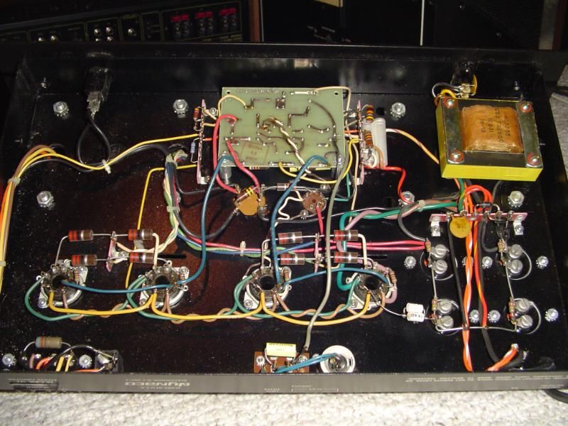

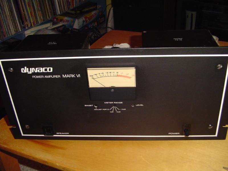

    I just discovered this forum last night and I thought I would say hello as I am presently recapping and rebuilding a pair of Dynaco Mark VI monoblocks.
    Here are a few pics.

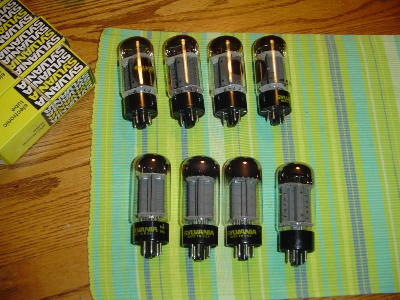

    One of my amps has a bad tube and the alternate Japanese transformers. It is nearly 5lb heavier than its "little" brother.
    I have ordered new caps, resistors and the dual section cans. I also bought two sets of matched 8417's.
    I'm not a tube amp guru but I have learned a lot. These are my first tube amps and they will be powering a set of Altec 19's. I don't know what the future holds for these amps as they are fairly rare and the supply of the expensive 8417's is dwindling.
