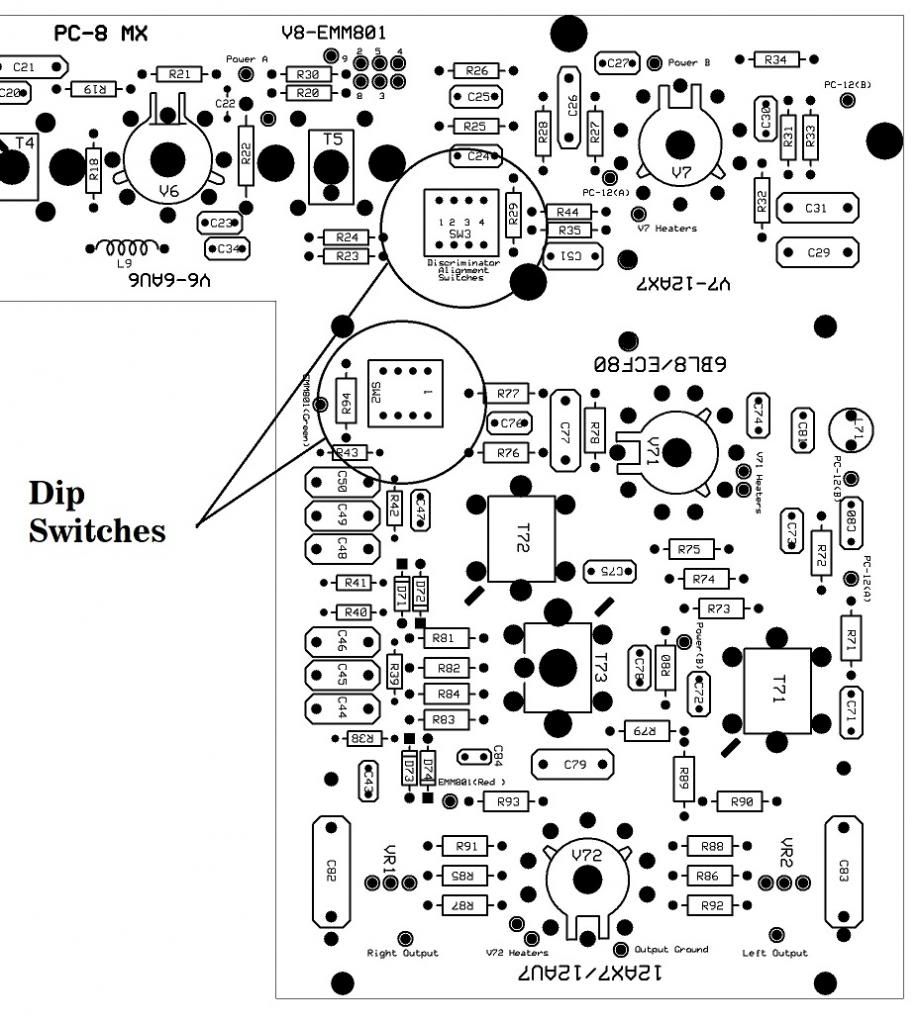

Well after months of working on amplifiers,preamplifiers and loudspeakers,I finally brought out one of my FM-3's to re-tube,and play around with,and re-kindled an old love!!! What's old can always become new again,and I must say this the Dyanco FM-3 just does it for me. I am just about to put out my first MOTHERBOARD for the FM-3,using modern day DIP switches for easy alignment,which I know can be a headache sometimes. I have at least 4 FM-3's I want to re-build over the next few months would love some input. I want to salute Bill Thomas again for his wonderful admiration and dedication to the restoration of the FM-3's and 1's of course!!

Hey Bob,
Nice to hear from you again. I am simply amazed at the popularity of tubes now, I know solid state is trying to make a come back with class D amplifiers,but I think nothing can top tubes!! I've listened to the best of the solid state stuff from Krell to Threshold,and Levinson,but I keep coming back to tubes,and Yes the FM-3 is a wonderfully sounding tuner. I live in a fairly rural area,about 90 miles from the Dallas-Ft.Worth metroplex and with just a dipole I can pick up several DFW stations,especially in the evening,and morning. The selectivity I think is a bigger issue with these tuners. Thanks for the input,I will post a pictoral of the PCB here shortly.
Denny

Here is a pic of the PCB. I have highlighted the DIP switches.

I will include a set of schematics w/ instructions on using the dip switches for the alignment process,and you simply follow the instructions set out in the original FM-3 manual for the actual adjustments.
