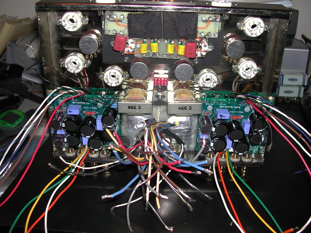

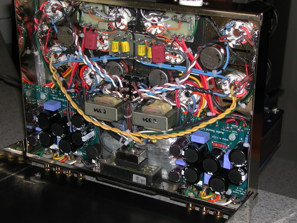

    Here is a Dynaco ST-70 amp rebuilt by Georgia resident Jeff Davison on an original chassis. I think Jeff went for a "dual mono" rebuild with TWO power supply boards, two chokes, two rectifier tubes, 4 X bias pots and what looks like a driver circuit on two turret boards in place in place of a single driver board. For all the parts packed in there, this rebuild looks very well executed. I was not able to get a photo of the top or front of the amp ...

    A nice job indeed...
    I actually see a few of my parts in this build...Appears that parts are from a number
    of different supplier's. I would like to see a photo of the top side. Jeff..Can you
    post a photo for our members?
    Kevin @ Dynakitparts

    What a job! I hope nothing will ever burn in this crowded chassis... I wonder if it is quiet?

    It looks like there may be a couple of toroid transformers on there. I think I see two items where the power transformer used to live. I remember another Dynaco amp variant that did this a while back. We may get an idea of what the top looks like from the pics I put on my photobucket page. This person obviously planned things well as I agree it is a neat job for such a crowded environment. In fact on closer inspection I think this is the same amp
    http://s1212.beta.photobucket.com/user/baddog1946/library/Dynaco%20Variant

    Unless you live in one of those coffin sized apartments mayor Bloomberg is championing why would you want to cram so much stuff in such a tight place. Obviously builder had resources for larger chassis
    While workmanship appears to be top notch, it just seems like you're inviting problems. Noise,heat,lack of serviceability. Even birthing pain tweaks can compromise your artwork. I tip my hat to your craftsmanship.
