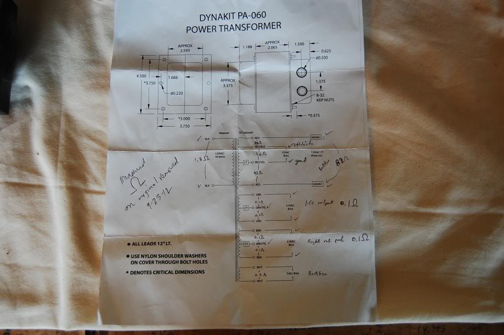

    Post by Elrick Wed Apr 03, 2013 9:50 pm
    I pulled my original power transformer a couple years ago when I upgraded my ST-70. I checked and recorded the resistance to the different leads at that time and put the transformer away. It was working at the time but I did have something going on with the amp during the restoration. Could you smart folks check my notes on the diagram and tell me if anything looks suspect? Unfortunately, I didn't check the various resistances on the new replacement for comparision. See picture, thanks.
