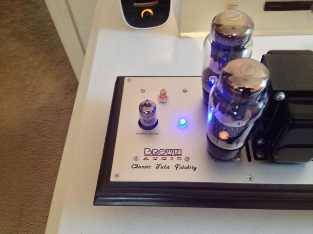

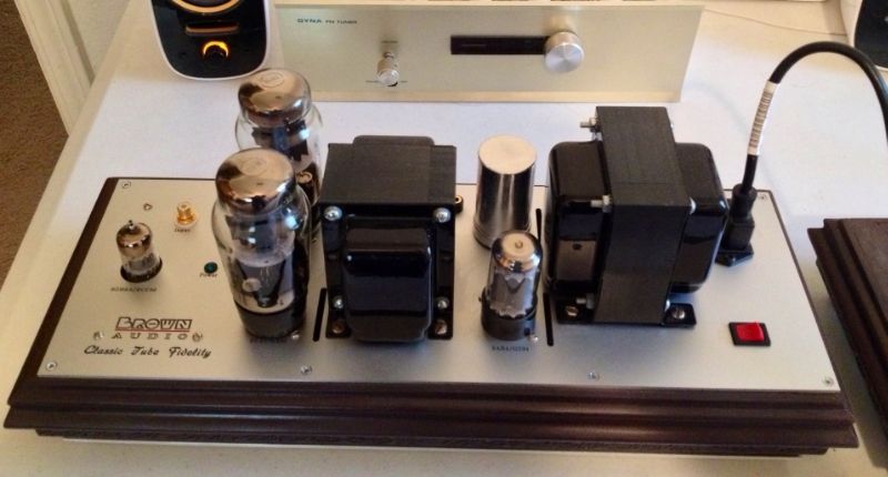

    I've been designing a layout very similar to the Mark IV with a custom top plate and wooden chassis.[img][/img][img][/img]

    this uses a different rectifier tube than normal, but is otherwise a VTA MK3 octal.

    Looks nice.
