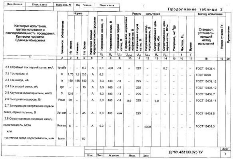

    Here's a unofficial KT150 datasheet (or part of) in Russian.  Hard to read but I think the heater current is 1.8A nominal and up to 2.0A max (row 2.2).   Row 2.3 maximum plate current of 180mA @ 400V = 72W!  If someone speaks Russian let us know what the tables have to say.  Thanks!
    From hificomponents.ru web pages if you can read between the lines.
    "KT150 Tung Sol . We had been heard out experimental samples. Sounding of a new radio tube was similar on KT120 and KT88 Genalex Gold Lion but more air and deep, wide the scene turned out, sounding of a low-frequency range became lower and fundamental and thus clear, a voice more natural and live, top at a lamp pure free and the main thing not раздражающе ringing. Also have still noticed one feature in sounding KT150 sounds became last Cesaria Evora there was more live. We heard such similar effect at comparison of cables, on Western Electric. The radio tube has the big capacity. Comparisons were spent on amplifier Cary sl80. And though direct replacement power vacuum tube KT88 on KT150 it is not absolutely correct, it works not absolutely in the modes, but even so the essential difference in sounding of these lamps if the amplifier under these lamps adjusts sounding even better was audible."

    Hi Arledgsc, any chance of up sizing the chart 50% or double. At this size I am unable to read. Even though I don't read Russian I think if you compare it to the KT120 data sheet you can probably figure out what is written. The tube looks like that building in London. Never seen a bottle that shape before.

    Sure... I cranked up to maximum 800 pixels wide allowed by the Photobucket editor.  Not a lot of resolution in the original copied so the Cyrillic text is smeared.  But it may be easier for you to read.....
    I can make out row 2.3 "ТОК АHОДА, mA" which translates to English as "Anode Current, mA".  (My Ex is Russian so a little rubbed off).
