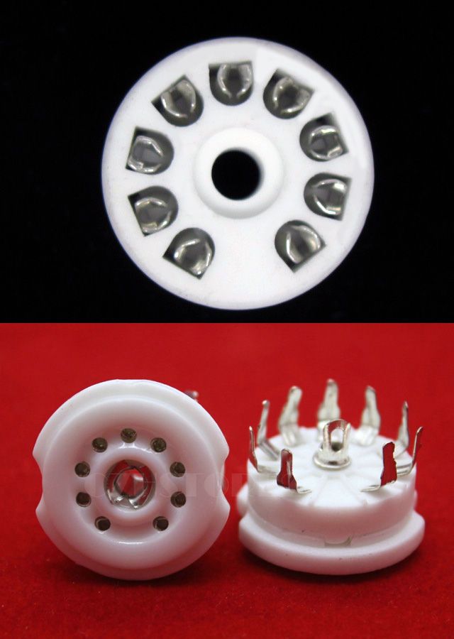

Re: Favorite driver combo?
The 9 pin PCB ceramic tube sockets on all the VTA amps are made for "tube jockeys". The composite photo below shows the type of 9 pin ceramic tube sockets used on all VTA amps at the TOP of the photo. The reason these are used is that you can bend in the two pin holders from the side with a small flat jewelers screwdriver should they become a little loose from repeated tube changes. The lower part of the photo shows the other type of ceramic 9 pin PCB tube socket. These have a smaller hole which does not allow you to get a small screwdriver in there to retension the pin holders in the socket.
To retension the pins on the socket I usually use TWO small flat bladed screwdrivers and push the two pins towards each other a little on all 9 positions. This will give you better tension on the pins ..
