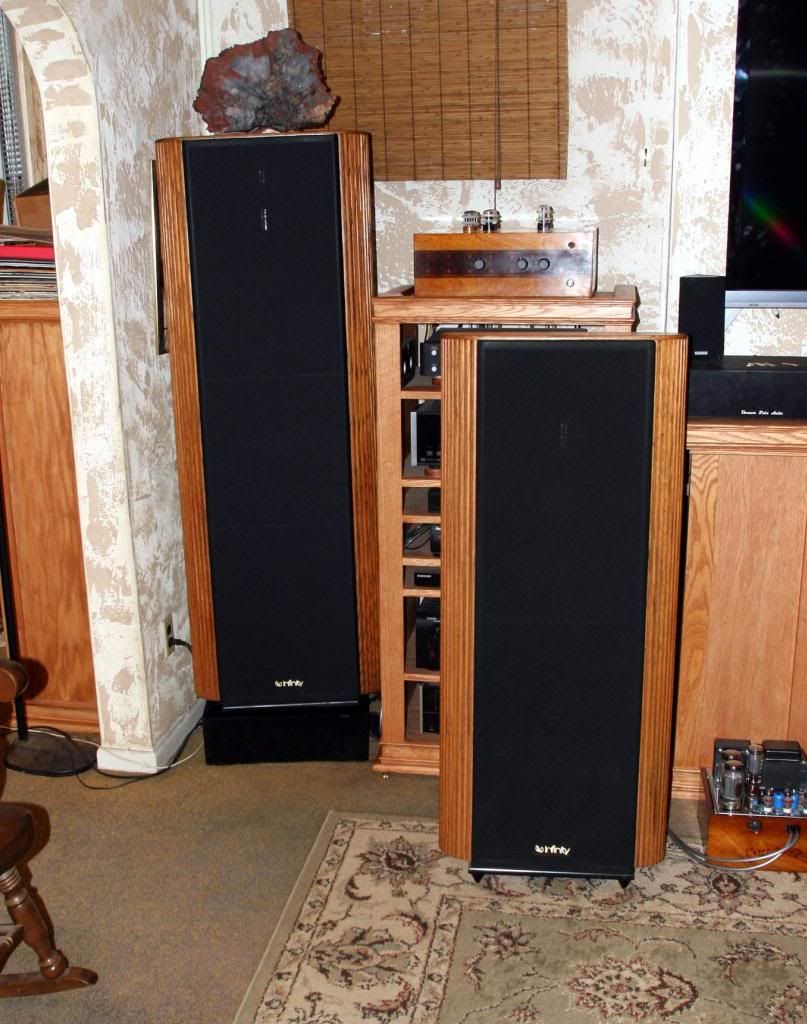

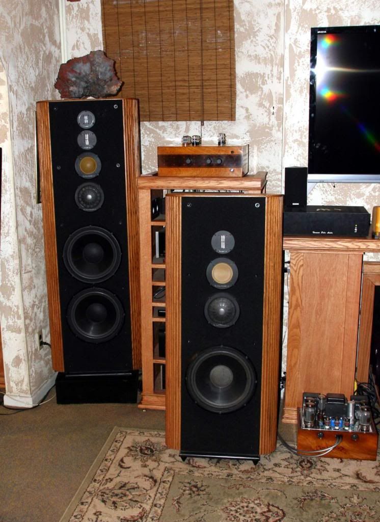

    I bought some new  (at least to me) speakers  a few weeks ago . I’ve wanted them for
    almost 25 years  but couldn’t find a store reasonably close that had them back when they
    were for sale in the late 80’s.
    A pair of Infinity kappa 9’s  .
    I bought the stores last pair of kappa 8’s instead back then , I got a killer deal on them too !
    But always wanted these babies  .

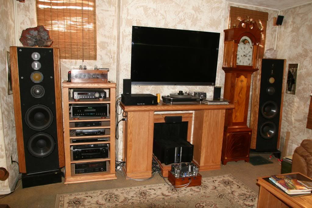

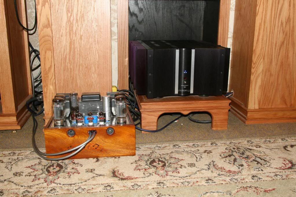

    I planned on bi-amping these before I bought them because they need a lot of  hi-current
    power  to work right . So I was going to use my FPB 300C to run the  lows  and was
    thinking of getting a pair of M125’s for the  mid-high sections . But for the heck of it I
    hooked my ST120 up on the mid-high section and I’m amazed at how well it works there
    . I was sure the 60wpc from reading some would be not enough .  ( It wouldn’t run the full spectrum of  kappa
    8’s very well  at all ) .  But so far they are sounding  pretty good like this .  So I might just
    get another ST120 with the  Octal board for these instead of the M125's ? I have alot of extra 6SN7’s
    from the SP14 builds .  Very Happy

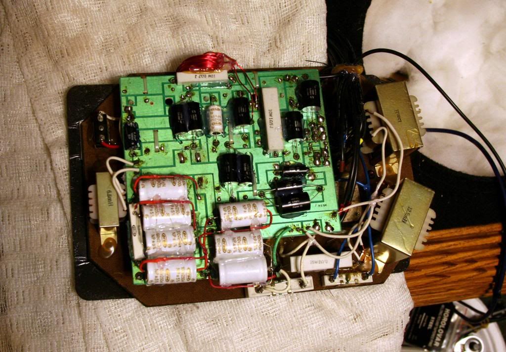

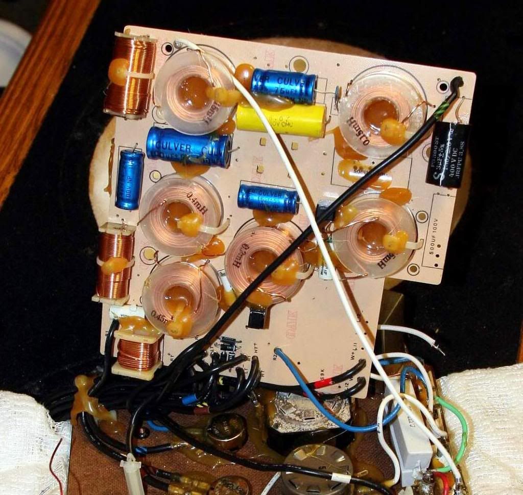

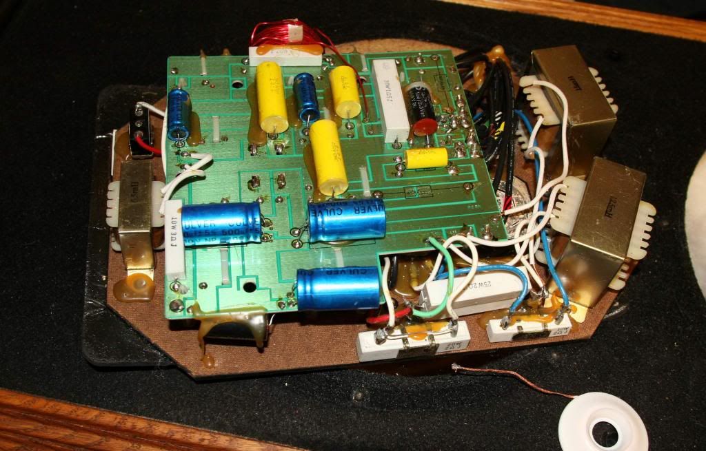

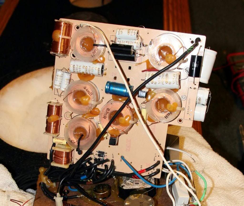

    The Speakers when I got them were WOOPED !  I wish I would have heard them in my
    system before I bought them ! He had them hooked up to a little crappy reciever when I
    auditioned them  and couldn’t properly power them.  I might not have bought them !
    The grille cloth looked like they housed a moth collany for ten years. At least I knew that
    before I bought them though . And the cases had some little water damage to them .  But
    when I got them home and hooked them to my system   I heard  some dissapointing
    sounds  coming from them . The woofers were supposedly refoamed  but one voice coil
    was seriously scrapeing and the foams were comeing loose at the glue and  two dust cups
    smashed in and crackaling ! One of the low tweeters was buzzing , the two high tweeters
    were not working at all , and  the rear tweeters were  working very poorly. OH ! and
    whoever  reinstalled the woofers wired them wrong! In parallel instead of series .
    Needless to say the bass was almost non existant . So after  three weeks of messing
    around  waiting for caps and foam kits .  Two grill re-cloths , two oak case repairs ,one
    used woofer ,four woofer refoams ,voice  coil re-centers and all new dustcaps . One new
    (used) low tweeter , one high tweeter and  complete crossover re-caps they are sounding
    and looking   ALOT better .   I did get them for a decent price though, but I had to put alot
    into them to get them sounding right .
    Man the crossovers were a pain . Alot going on in there .  Alot of hot glue  Evil or Very Mad  and non standard  cap values .
    Not dynaco but  ...  Smile
    Before.
    After.
    Thanks to some info here  and Building  my  ST-SP & PH builds  I was able to figure out what was wrong with these monsters . A couple years ago i would never have even attempted it .  There was a total of 6  bad or very out of spec capacitors in both crossovers  . From my research reading the electrolytics usually go out of spec from age and the  film Solons usually stay good .  But it was just  the opposite on these , the Electrolytics all checked in spec and  all the bad caps were the Solons. One of the 3uf caps actually read .02uf . Figures since I replaced the films  with new Solons  Rolling Eyes  since I didn't want to spend  what  the Sonicaps would have cost !!

    Kappa 9's on left   8's on right .

    Wow! That's quite a complex crossover. I would've replaced every single one of those electrolytics and iron core inductors but that's me. Being on spec is only half of the issue. Film caps discharge faster with less resistance and just sound better. At the very least I would bypass every one of those electrolytics with a small (0.1uF) film cap.

    corndog71 wrote:Wow!  That's quite a complex crossover.

    I replaced all the caps on both crossovers , electrolytics included . I've read about  crossing over the caps with a small  .1uf cap but didn't know enough about why  to try it .  Three of the film caps were already crossed over with a .01uf cap though . I don't know  enough about this yet  to  start changing things like the inductors , that and the cost of all of them .  Doing the caps was it for now .  Besides they are all back together . I'm thinking of doing the kappa 8 crossovers  eventually  may be I'll do them up "right" .
    They used 12 ga wire on all the wireing in both of  these speakers too , even the tweets .

    At least you have room for the big caps on those boards .  I can't imagine finding space on mine for the 2000uf of film caps that just each woofer section takes . That and the cost !  Just zip tie them down and get yourself a hot glue gun and  glue them down . Everything on mine was  hot glued and they were a pain to get loose !

    Since I didn't get many opinions on whether a attenuatur  between the pre  & the amp would  work to balance out the input sencitivity mismatch I built a simple with  box with an attenuator & inputs and outputs  in it . I worked out very well , the sound is much more balanced between the highs and lows  now rather than  the weak bass without the  attenuator now that I'm able to turn down the bias to the  ST120 .
    Its  a small Goldpoint case with a  old stereo attenuator  I had around . Since  I was too lazy to build a wooden box to match . Wink
