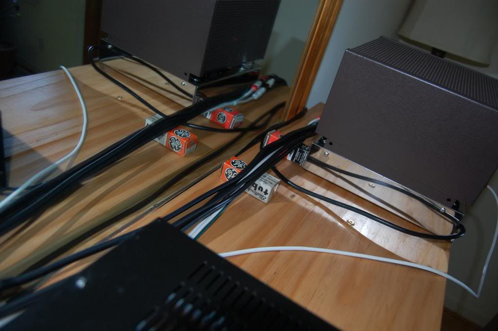

    My house is old, I have only two prong plugs which are not grounded. All my stereo stuff is plugged into a power strip that goes into an old 20A variac that is also not grounded. It just has an old reversible two prong plug. So I'm probably not getting any grounds loop there. I think I'll try reversing the cord from my variac into the wall. That could make a difference humwise.
    I've tied to separate the RCA source lines from the power lines as best I can with my set up. If they have to cross then do it at right angels.

    As you can see, I've paid extreme attention to cable routing on my system ...

    sKiZo wrote:As you can see, I've paid extreme attention to cable routing on my system ...

    with that spaghetti audionaise I'm surprised you're not getting cross talk!!!!  cyclops
