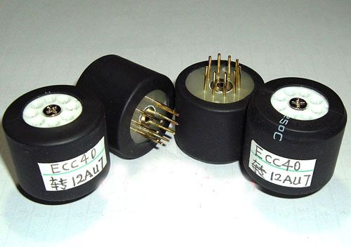

    I seem to remember someone tried it with good results. You can get adapters to plug an 8 pin tube into a 9 pin socket, but I expect there was also some pin swapping inside the adapter involved as they're made for an ECC40 application.

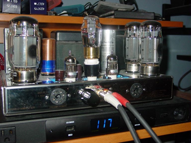

    Been using the 12AU7/6SN7 adapter for over a year in the center position of the ST120.  Works great and love the sound if you have the vertical clearance.  Just search Ebay "6SN7 12AU7 adapter".  Be sure to get the right flavor - 8 pin on top/ 9 pin on the bottom and 6.3V version.  The same adapter will work for 12AX7/6SL7 needs as well.  I can highly recommend the experience.

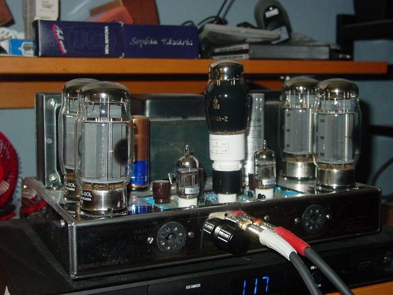

    Is that a Mullard ECC32 you're running? Neet bottle ... be a nice match for my GZ37 rectifier.
    Was looking into a Full Music 6SN7 a bit back ... few hundred bucks cheaper anyway ...

    It is a Sophia Electric 6SN7 which looks exactly like the TJ Full Music 6SN7.  I have both and they sound OK after 50-100 hours of burn in time.  My favorite new stock of the 6SN7 types is the Black Treasure CV181Z.  I could go on and on about the BT virtues in the ST-120 but it has bested any other tube tried in the center position including NOS of all types.  The BT CV181Z is an even larger bottle and takes a LONG time to burn in but well worth the wait.  PM me if you want more detail on each type.
