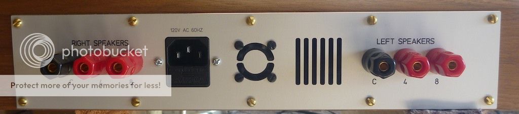

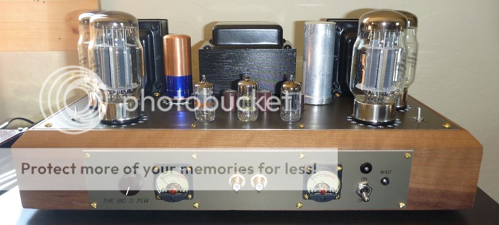

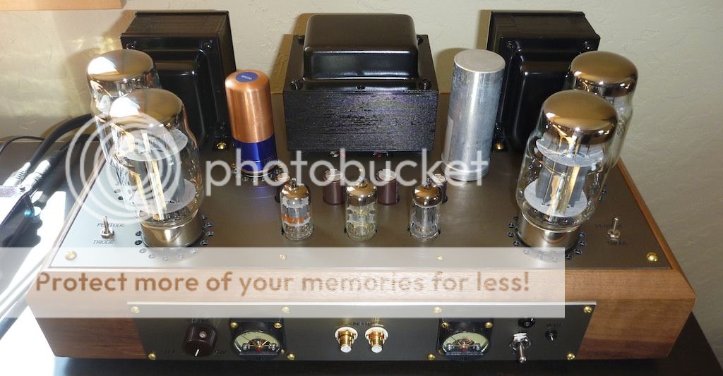

    this is my latest build, a custom VTA ST70 in a Hammond chassis with mini retro look VU meters.
    I kind of stumbled across these VU meters. A true VU meter they are not I guess, they come with their own driver circuit and you can either have a low level signal or high level signal input.
    Low level is preamp level output, no good in this instance as it will interfere  with the amps input.
    So I am using the high level input, straight from the speaker output, hence not a true VU reading. The VU meter driver board comes with two trimpots to adjust the meter deflection and I guess one can get close to a correct reading.
    If you buy these as a kit, they come with a neat little fully encapsulated mini transformer, capable for 115 or 220V mains and with 6,9 & 12V tappings. It is small enough, as is the VU driver pcb, to fit inside the chassis.

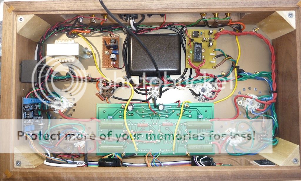

    I don't have an inside chassis shot yet, will post one once I get a chance to take a couple.

    Your custom VTA ST-70 amp looks really nice. You did an excellent job on the assembly of the amp .. Yes - post up a shot of the interior wiring when you get the chance ..
    (NOTE - wiring photo posted above on 9/7/14)

    inside view shot added, you can see the mini transformer and VU driver board on the left
