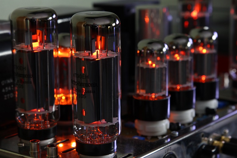

    Post by Tevian on Wed Oct 01, 2014 4:11 am
    Ok returning back to the KT90EH...
    I recieved them a few days ago. So far they have maybe 15 hours on them.
    I would like to restate that i'm very new to the tube sound. So I hope this opinion will be useful to someone. Smile
    Current system is a rebuilt ST-70 using the VTA driver with 6SN7 tubes. Also i've opted for a new power tranny. Picture is the third down on http://www.tubes4hifi.com/ST70.htm main page thx Roy. I'm running all custom speakers and custom crossovers. Dayton Audio RS125-4 x 2 and Tang Band 28-847SD per cab. Listening source varies. Pro-ject turntable and digital sources.
    Currently I have them biased to 50ma. I believe my bottle neck for power is the stock ST-70 OPT's. That being said the system provides plenty of power for my needs.
    If you haven't seen a comparison check out the pic below. Although the tube glass is roughly the same size the tube elements are much larger. You can see the base is very low profile. I kinda wish it was a little more substantial. At first glance they are not as different looking to the old KT77's as a KT88 or fat glass tube would be. So.. they are larger but not as impressive looking than a KT88 would be I guess.  Cool
    At first power up I noticed the highs being a bit soft and the bass was over emphasized. I came across a post with a similar experience so I don't feel alone in this. They have leveled out but there are still very new. Right now they don't sound terrible. The bass is still a bit heavy but not all together unpleasant. Once I get more time on them I will try to give a more detailed impression. Right now i'm on the fence.  Neutral  Just got the Gardians Of The Galaxy LP. Its not sounding to bad right now.  Cool
    These observations are in relation to the EL34 and KT77 tubes I was running previous. Also my complete lack of exposure to any other tube amplifiers. I preferred the sound of the KT77  over the 34's so the 34's were shelved quickly after I got them. I will have to try the 34's again to see if my opinion stands.
    No love for the KT 90? Img_4610
    No love for the KT 90? Img_4611
    No love for the KT 90? Img_4612
    No love for the KT 90? Img_4613 ---KT77---
    No love for the KT 90? Img_4614

    Post by zx on Wed Oct 01, 2014 8:49 am
    Thanks for the info an pic..................I to like the tone of 6SN7 inputs
    i have had the EI KT90 for years....these EI are not made any more..the KT90 can take 7-800B+v on there plates....if there ran with 600v on the plates thay do open up an topend gets better....but i dont like the sound of any output tube ran with more 460-80....ran on there plates
    But sound wize your right on....the top is not rolled off ......But it sounds to me like the mid is push out an the base sounds fat..some amp input tubes can match well....but the 6SN7 can sound dark with some tubes....KT90,KT88.....an maybe the KT120s-150s.........6550s an the 6SN7 is a sweet setup...an some of the topend i ever had.............
    The top-end on the KT77,EL34 well be much more open...well to me
    I have got great sound out of my Dynaco MK3 with the old stock 6AN8 inputs....
    there top-end can sound brite...the KT90s sound right in this setup.....

    Post by sKiZo on Wed Oct 01, 2014 1:25 pm
    Good info ... nice to see a "real world" review. Also impressed with the EXACT matching based on the box stickers ...
    Pushing the bass can be a good thing, and something I like about the KT120's. Long as the mid bass doesn't get muddy, I'm cool wit dat.
    Pushing the mids is also a good thing IMHO, as that's where the ears typically begin to fail as we age, or at least fail in the spectrum that's most noticeable, as in vocals. I agree the B+ could be a factor as the tubes will never develop their full potential in the ST120. Then again, same could be said about the KT120's, although they perform extremely well in this application.
