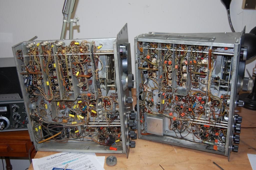

    I'm getting ready to throw in the towel on this problem. Part 24 can't be removed from the shaft, looks like it's welded or brazed together and the only way to remove it is by pulling it out from the rear, but to do that I have to remove the whole damn tuning assembly. At least I know have a new set of Bristol Wrenches.
    I guess I'll put it back together and sell the donor unit and try to modify the other so I can somehow engage the brand spread tuner. It's too bad, after being re-caped the donor unit receives FM well but it has a B+ short on the band switch wafer when set to AM mode, burning out a resistor in short order.
    Not really audio related, but maybe someone here has some mechanical aptitude DSC_2975_zpsa7951946
    The donor is on the left, the fully working unit is on the right. I must say working on Dynakits is a cinch compared to this complicated beast. They do sound nearly high fidelity with 2 PP 6V6 and a nice speaker. This model covers the complete frequency range from broadcast AM all the way to FM, and once properly aligned and restored they are a really quite capable on the shortwave bands. I read that President Kennedy had it's successor, the Hallicrafters SX62 on Airforce One.
