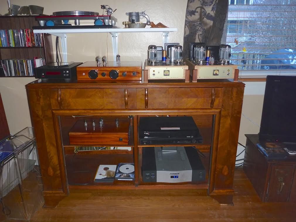

    Here are two photos of my stereo with MontanaWay's new Big Bopper (I call 'em Bad Boys) amps, personally delivered this past weekend.
    They are beautifully built and wired, and the sound . . . what can I say? Makes your socks roll up and down.
    I will write a more detailed review but want to see if this post with the picture references work.

    Bill, thank-you. It's been 3 years and a gob of help from a lot of friends (the gang on this board) to git 'er done.
    Holger takes the M-125, or any other VTA amp or preamp, a step to the next level. And he's not ripping off the VTA/tubes4hifi gang. They work together. Granted, much of what he improves is aesthetic, but he's a fuss-budget about noise and his wiring and workmanship are impeccable. My M-125s came back better than when they left, and the biggest improvement (other than great looks) is the distance he puts between the back output tubes and the xformers. Definitely runs cooler.

    David - Your "Holgerized" VTA M-125's look great ..
    Posts : 1795
    Re: Going woodie. MontanaWay's modified M-125s, the Big Boppers
    Post by deepee99 on Wed Nov 12, 2014 2:35 pm
    Thanks,
    You oughta hear them! My neighbours now listen to good music, whether they want to or not.
    Holger swapped out a few parts and put in the new driver boards (didn't realise I had the old iterations) and they run like a raped ape. He adds a bit of elegance to the whole package.
    Think I'm gonna stick with McShane's Russkie KT-120s and NOS GE or RCA drivers from now on.
    Upon audition, Art Pepper was literally in our lounge with his sax.
    This speaks to the quality of the M-125s. They are sturdy and utterly transparent amps. Thanks to Dave Hafler, and to guys like Bob, Roy and Holger for bringing them back to life.

    Looks like a wood phono preamp and a wood preamp? What is the scoop on those two? I saw MontanaWay's thead when he was building these for ya. Set for life!
    Posts : 1795
    Post by deepee99 on Wed Nov 12, 2014 2:58 pm
    mantha3 wrote:Looks like a wood phono preamp and a wood preamp?  What is the scoop on those two?  I saw MontanaWay's thead when he was building these for ya.  Set for life!
    Don't think you can go wrong with MontanaWay. His website is: http://www.tubenirvana.net/
    My woodie preamps arrived a bit noisy from other sources; Holger is a no-noise-and-distortion freak so they will be sent to him for an overhaul as time and money permit. Good guy.

    if anybody likes the look of the woodies that I made fore Dave, I do offer this service to anyone. This offer also goes for ST70's and ST120's.
    And for members of this forum, I will give you a good deal.
    There are several styles of custom wooden chassis' available, from darker wood to lighter wood finish like Dave's, inside our outside chassis feet.
    I re use most of the components from your original steel M125, ST70 or ST120. If your M125 happened to have the original non CCS driver pcb, I will need to update yours to it, as the hole cutouts on the top panel will not suit the original driver pcb. I would think that most members here already have the correct VTA driver boards for the ST70 & ST120. I also do both noval and octal versions for the ST70 & ST120.
    You will get, with this service, new wooden chassis of your choice, left and right handed or whichever you prefer, new bronze anodized aluminum plates, new ceramic tube sockets, 4 & 8 OHM gold plated speaker posts, input either on the front panel or the rear of the top panel, (There is NO rear panel on my versions of the M125, but there is one for the ST70 & St120 versions) new power receptacle with the appropriate right angled power cord or straight one for the ST70 & ST120, retro VU meter, two on the ST70 & ST120, volume control, on/off switch with LED and a "WAIT" LED on the front panel.
    You will also get a new TDR, time delay relay, unless your M125, ST70 or ST120 happens to have one, then I'd use that.
    That "WAIT" LED is tied to the TDR, it goes on on power up, then after about 10s goes off, meaning B+ has now been applied to the driver tubes.
    Each amp will also have a mini cooling fan.
    Turn around is about 7-10 days.
    If you are interested, 'pm' me.
