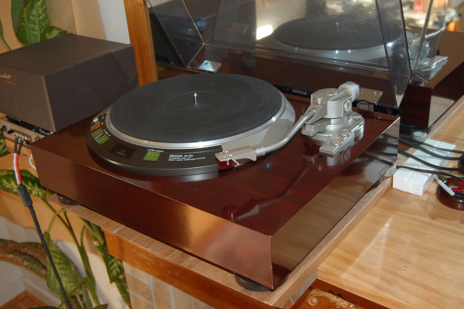

    Count me down as a fan of the 80's direct drive tables. Picked up this Denon DP62L a couple months ago, it's paired with a Denon DL110 cart. From the very start my LP's both old and new have never sounded better. This table is large, heavy, dead quiet and rock solid.It's very well engineered with outstanding spec's and you can hear the quality. One fun thing to do is turn off the power when it's in the middle of a track and wait and listen for the table to stop spinning, requires about a minute and a half for the platter to finally stop turning. Turn it back on and it spins up and locks in about 1/2 a second. It's so large I had to modify my stereo shelf to accommodate it's footprint. Anyone else use any of the Denon L series tables of this era?

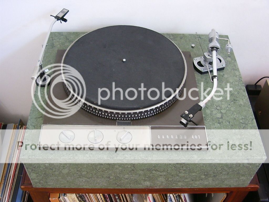

    In the meantime, here's a picture of my last Garrard 401 with green marble plinth and SME 3009. Sounded nice. The 'mat' is a drum silencing pad: highly recommended!

    Elrick, love that Denon and have been looking for one.
    Also have the DL-110 cartridge -
    Amazing for the money and my favorite for older scuffy scratchy stuff.
