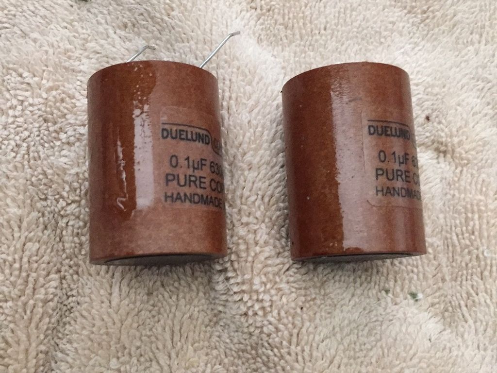

    When I had the chassis open I also noticed my Dueland preamp-to-phase inverter coupling caps were leaking all over the bottom of the chassis.  That really pisses me off especially for what they cost.  I had some Mundorf SIO 0.15uF caps and substituted those.  Wow!  I was missing a lot of low level detail with the leaky caps.  And now have more bass as well.  I think I am going to like the Mundorf SIOs.  So today has been productive.

    I have the ST-120 with 1200 hours and the Russian PIO caps no complaints here, My SP-14 has the Mondorf SIO amazing sound had wondered about swapping out the Russian caps for the Mondorfs in the ST-120 keep us updated as they break in
    Curious how did the Dueland's perform initially, after how many hours of break in? and how many hours before the melt down occurred?

    The Dueland caps sounded great when installed 2 yrs ago and wasn't much of run in period. Warm with a lot of detail. I use the ST-120 every day and at least 1,000 hrs. per year so about 2k hrs total on the Dueland's.  I guess they just deteriorated and my hearing has been stuffering for while so probably did not notice a slow decline.  The ears are fix but the amp sounded bright and little raspy in the vocals.  The insides of the ST-120 must get warmer than I imagine.  But a cap shouldn't leak in a tube amp so glad to find something else.  A cooler pre-amp or speakers are probably best applications for the Dueland CAST types.

    This isn't the first time I've read about duelunds falling apart over time.

    I read that also. It appears many oil and wax impregnated caps don't really like to be subjected to higher than average temperatures.
