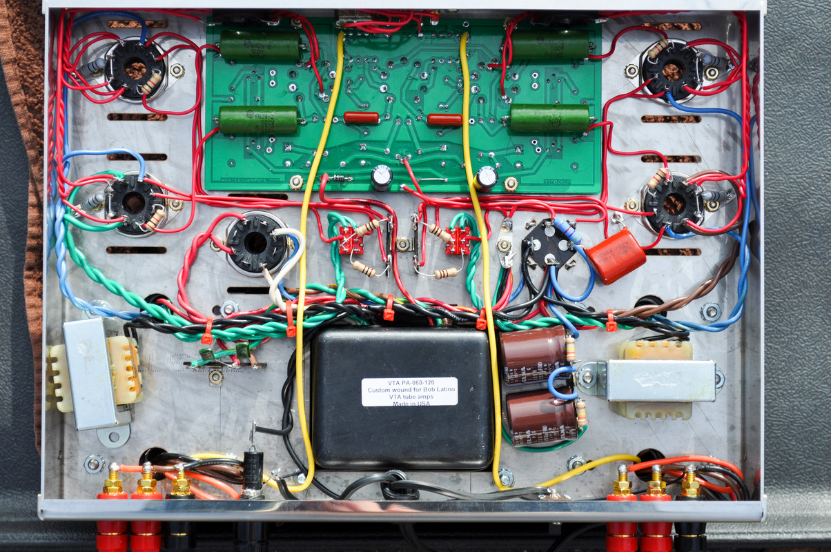

    VTA M-125 amp wiring below
    VTA ST-70, ST-120, M-125 amplifier information M-125-interior-wiring-2
