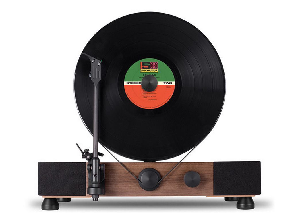

    This is a new concept in turntables if I ever saw one .. The Gramovox vertical turntable. Comes with a built in amp and two speakers. has line level outputs in the rear if you want to run it directly into an amp. Headphone jack also. Read the details at the link below and be sure to check out the video about 2/3rds the way down the web page. I do not think that these are actually available now but they do have a $399 "pre-order" price elsewhere on the web site.

    You would have to think that the LP would attract less dust in a vertical position. Smile

    Because for the target audience, image...appearance, looking cool...is all-important. It's COOL to play vinyl records now, and they value COOLNESS above all else. So not only do they have to play vinyl records (that's OK, I do, too), they have to LOOK COOL while they are doing it.
    They'll probably not even be LISTENING all that intently. Just looking COOL. Sizzle, not steak.
    The concept is sound, though. Dynamically balanced tonearm, first appeared in the late 1950s.

    meh!...just another gadget, no doubt though, it will probably sell well because its different.

    One imagines that even the slightest warpage would wreak havoc. "Why bother?"

    Kentley wrote:One imagines that even the slightest warpage would wreak havoc. "Why bother?"
    I bother !
    It can be done, therefor it should be done!
    I once rebuild a dual 1019 to play records standing on it's front.
    One prerec is that the tonearm is balanced in all axes, and the final "downward" pressure ( against the record) is done with feather power, so is anti-skating.
    I needed a slight mod of the platter bearing, the motor was ok: when runninhg it was
    held in "center". Then i used a tandberg taperecorder reelholder ( tandbergs could also
    be played vertically, then you only need to use rubber "holders" to secure the reels.
    Was it better ? Not really, one had greater risk of dropping the record when changing.
    But id sure raised some eyebrows !

    Same thing, only different.
    The old Mitsu vertical tables did all the same tricks, albeit with more of a standard look ... for a linear tracker anyway. Most do develop issues with the arm, but can be restored with a bit of TLC and head scratching. Built like tanks otherwise.
    PS ... a vertical table actually makes sense. Required tracking force is relatively low as the stylus isn't fighting gravity, and you end up with much faster response and more delicate nuances - IF you use a cartridge that won't get confused with the different dynamics involved.
    I'll leave the pros and cons of a linear tracker out of it, as that's one of THOSE debates. In this case though, I'd think a true linear arm would be more logical.

    The importent thing with all tonearms are that they are statically balanced, that is when no
    downforce is applied and antiskating is zero, then the arm stays in whatever position it is left in.
    When the arm is balanced the it's also neutral against vibrations and any non-horisontal player.
    An arm of this type will have spring(s) to create downforce and antiskating ( or magnet as done by some ortofons)
    There is other technologies that is not balanced but still works well. There is several ways to build a good player.

    i wonder if they offer a right-handed model... I would likely ruin a record/cantilever or two trying to cue using my left hand! As I recall juke boxes have been playing 45RPM records vertically since forever. Remember that the ubiquitous Rega RB300 arm applies VTF via spring.

    One reason I can think of is it might have a much smaller footprint if you've got a cramped stereo hutch.
