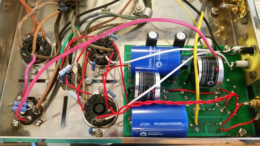

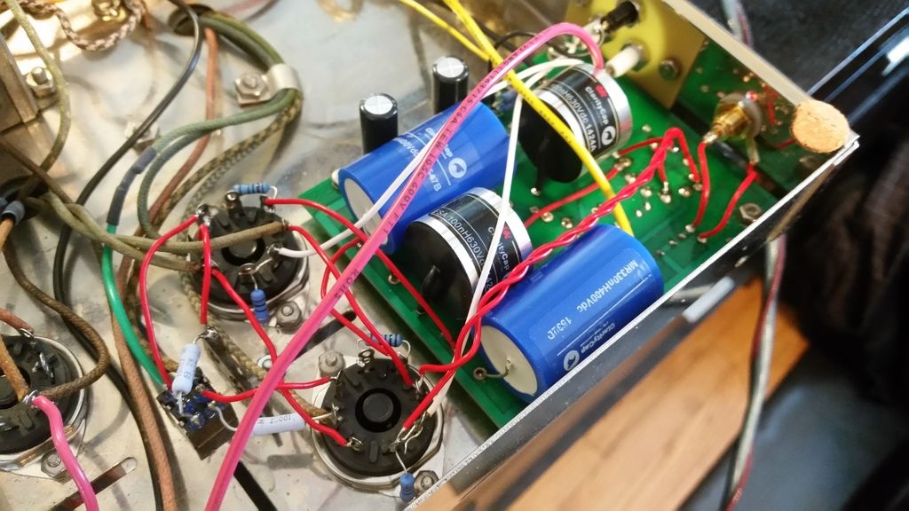

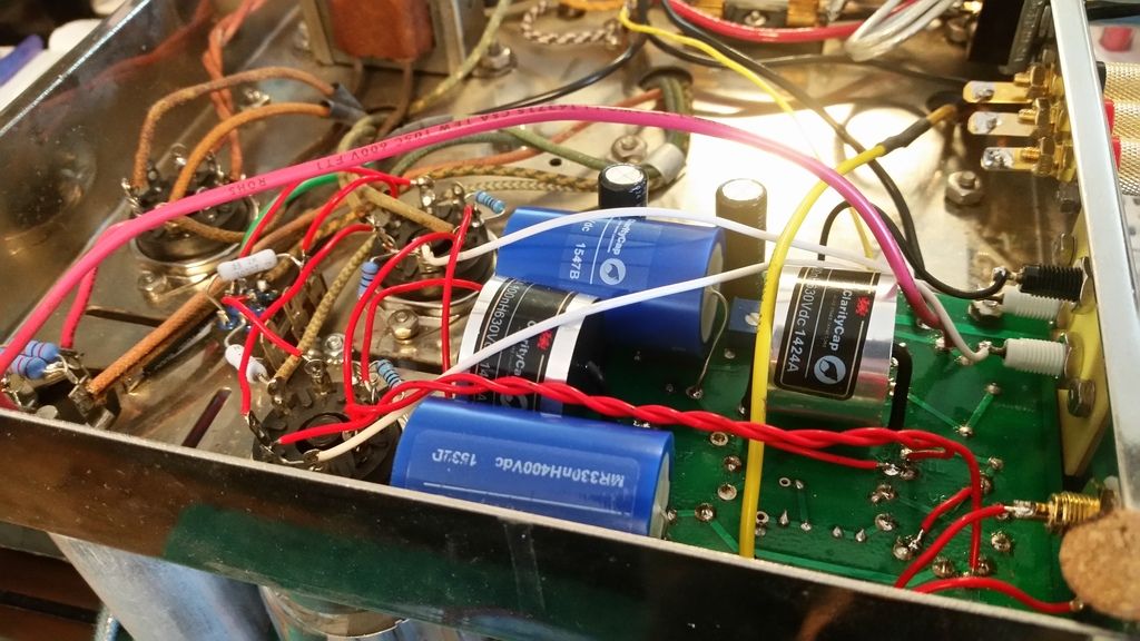

    so i resoldered filament wires completely, also went over all the other solder joints with hot iron and added solder, made sure good connection etc. still no go. here is a photo of powered up amp with completely different tube set that i know is good from my other mk3 amp. as you see no power to  driver tubes. speakers connected when test power on and i didnt bother with bias during brief test. i dont see anything fried and jumper wires on pcb are good. i dunno.

    looks to me like your filament connection is incorrect. That twisted pair of wires going to your driver pcb, I assume are filament wires?
    If yes, one of them seems to be going to pin 1&8 on the driver tube...it should be going to pin 7!, as the filament pins on the driver tube are 2 & 7
    Re: driver tubes dont light up after hookup wire replacement in mk3[PHOTOS]
    Post by Guest on Sun Jun 19, 2016 11:21 pm
    also, did you connect ground to the driver pcb? I see a wire in the B+ pad, but not in the GND pad next to it

    MONTANA you are right. I cant beleive i made this mistake yesterday, maybe because it was 3am and NEEDED to install my new LAT International 20ga hookup wire. I will fix it now. I feel like a moron but i am glad nothing fried...that i could see. ok ok let me fix...
