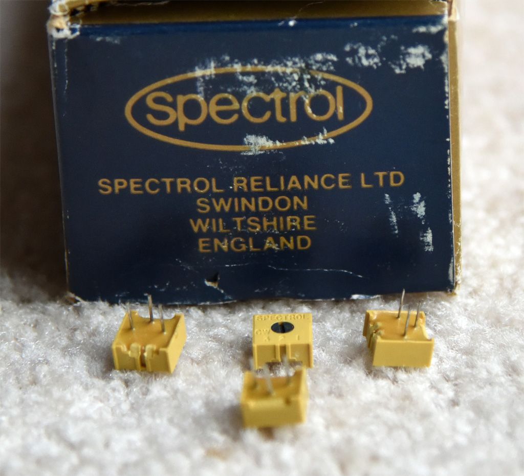

    Dave,
    The stock VTA M-125's do not use the 50 cent Radio Shack bias pots. They use the more expensive Spectrol (tan colored) bias pots that are "Made in England". IMHO The Spectrol is the best bias pot out there right now. These have been 100% reliable for me. I will continue to use these as long as they continue to be available .. See photo below ...
    The great Sino-Soviet cook-off Spectrol%20bias%20pots_zpsjlyjb7iu

    The Spectrol trimmers (50K ohm p/n M63P503KB40) are not stocked at Digikey.  Mouser has them and both places want about $4.50 each.   Allied Electronics has them in stock for $1.28 each.
    Spectrol 50K ohm trimmers at Allied Elect
    I recently installed some 4-turn trimmers that makes adjusting bias a breeze.  The only problem is that the adjustment is backward - CW colder, CCW hotter.  Almost cooked my KT-88s first go until I figured out I was going the wrong way.  I also had a bad trimmer after installation that would not adjust so be careful.  You can verify installation easily with no output tubes installed and measuring the voltage on the output socket(s) pin 5.  They each should adjust between 0 and -70V with no tubes installed.   And the more negative voltage the colder the bias for starting points.
    When looking for trimmers the pitch between three pins is on 0.1" increments.  Metric versions will be slightly off.
