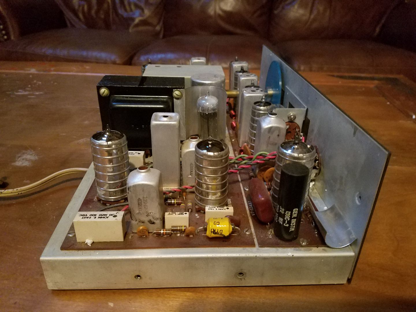

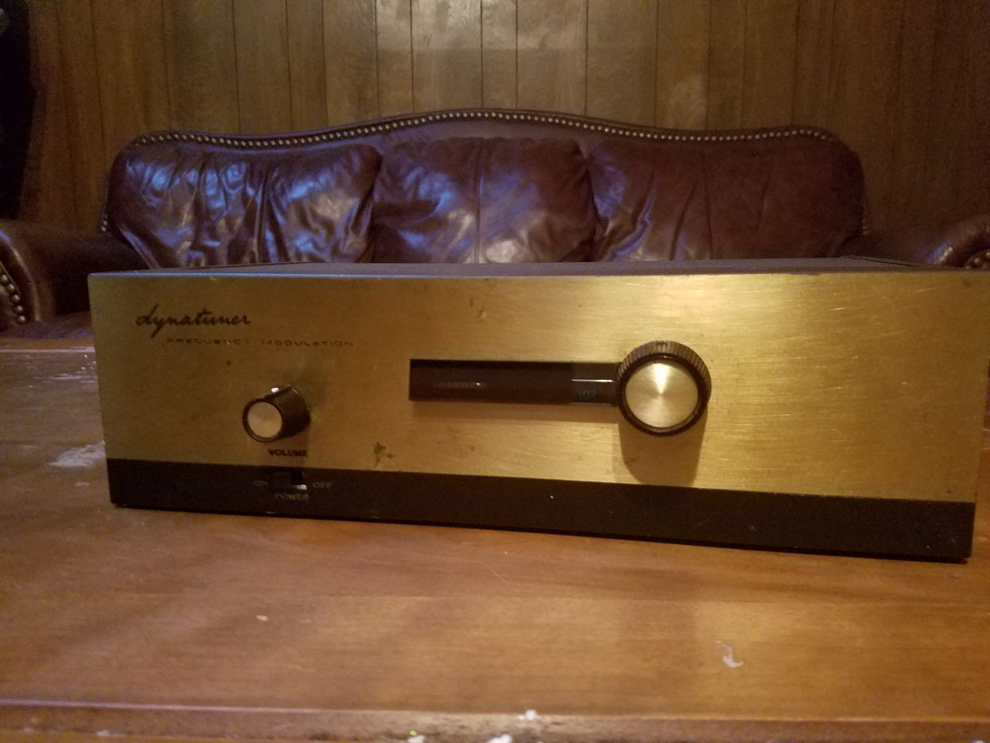

    I think I may have caught the bug  Shocked I already had a PAT 4 for years then got the PAS 2 recently and now this FM 1 I got the other day. It powers up but the blue eye wasn't blue and there wasn't any sound. Took the shielding off of all the tubes and they were lit except the rectifier but if you look at the tube, it is smoked so I have another on the way and then I will try again. These were taken moments after unboxing prior to cleaning and plugging in. Not sure where that piece of shielding goes that was lying loose unless it was supposed to be part of the shield around the rectifier.

    The rectifier is unshielded on the FM1 & 3. However, other than the EM80 eye tube for a 1, all the others are shielded. Note that the tube bases have a small metal tongue that friction-connects to the shield when it is slipped over the tube down to the base.
    The FM1S & the FM3 use the EMM801 dual eye tube. That, as it happens, is very nearly unobtanium these days. Technically, you have an FM1S as it has the stereo board. Count yourself lucky.
    That bit of metal looks like scrap.

    Won't work at all without a functioning rectifier. Don't give up on your EMM801 eye tube yet.

    the rectifier is a 6v4 / EZ80. I have in stock, but that won't help you i suppose.
    As already mentioned you can replace the ez80 with 2 1n4007 diodes ( or un4007) ,
    this could be done temporarily to check out the rest.

    Thanks for the info and suggestions. I got the rectifier a little while ago and put it in and everything is working perfectly now  cheers
