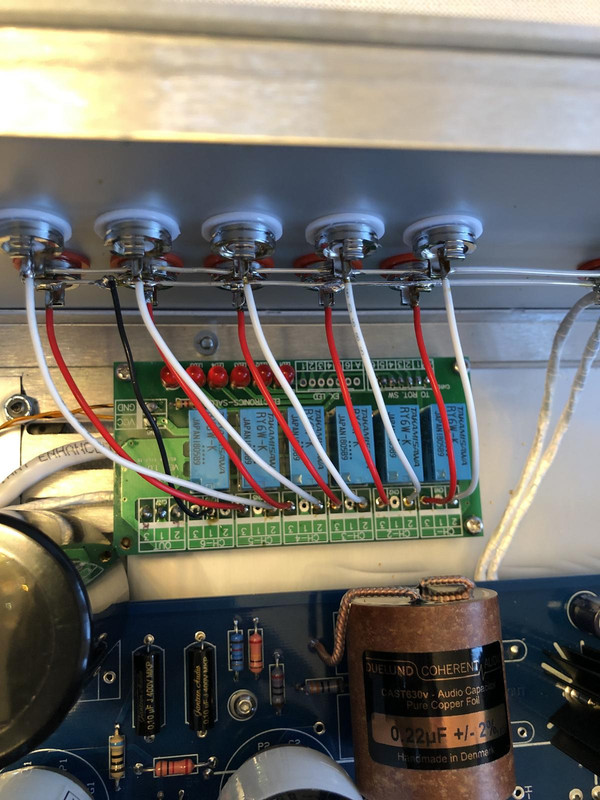

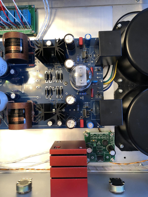

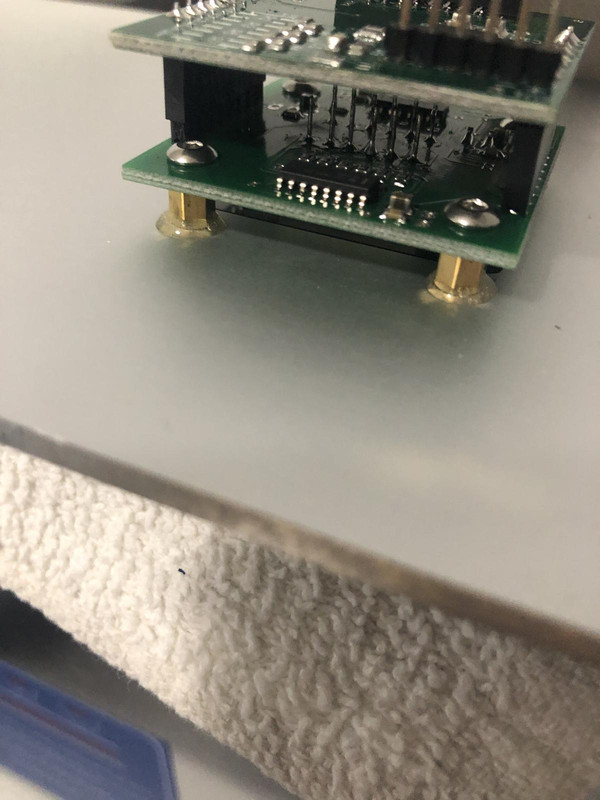

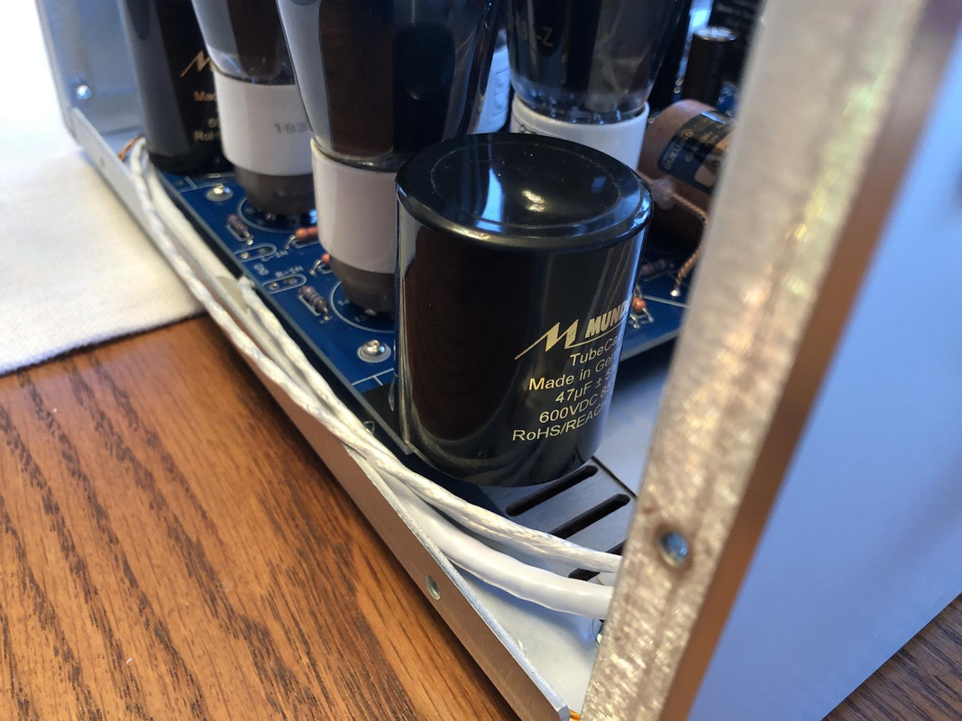

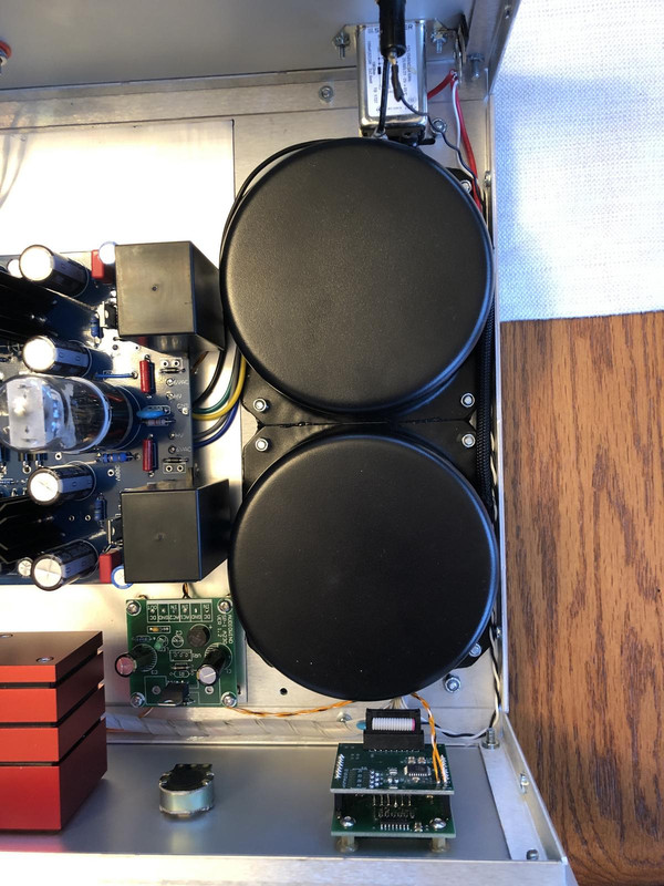

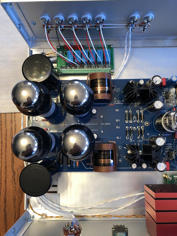

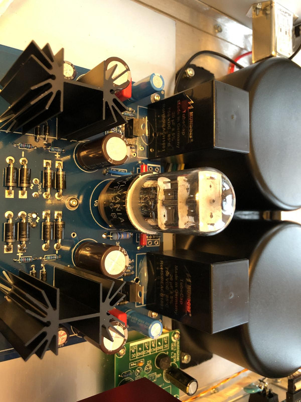

    Here are some images from my recent build.
    As always thank you to Roy for the kit and the assistance in ordering it how i preferred.
    The board is Revision P.
    I purchased the kit with the Tape switch, and inputs / outputs omitted.
    I omitted the balance controls from the final wiring. I forgot to order it with those holes removed as well.
    The chassis is lined with a sound dampener similar to DynaMat, it is a little different from what Roy lines the chassis with.
    The transformer covers are also lined with sound dampener, inside and under.
    The board is mounted on rubber o-rings between the board and standoffs.
    Here are some details about the components used in the build :
    Tubes ***
    CV181-Z  ShuGuang Treasure Matched Quad
    NOS Sylvania VT-126B 6X5GT Vacuum Tube Black Plates
    Resistors & Capacitors ***
    Audio Note, Shinkoh, PRP, Takman.
    Mundorf Capacitor 20.0uF 750Vdc TubeCap
    Mundorf Capacitor 47.0uF 600Vdc TubeCap
    Duelund Capacitor CAST/PIO-CU 0.22uf / 630VDC
    Source: partsconnexion
    Wiring Etc***
    24 AWG Gore Shielded Silver Plated PTFE Wire Twisted Pair
    20 AWG Silver Plated PTFE Wire White 19 strands
    Cardas Quad Eutectic Silver Solder
    Source: johnswireshop.com (ebay seller: NavShips)
    Input Selector ***
    AudioWind Electronics Salon A-130 Relay controlled input selector. Modified with 6vDC relays to run off of the same 6vDC used by the Khozmo Remote / Display. Purchased the 6vDC relays from Mouser and just swapped them out.
    https://images-na.ssl-images-amazon.com/images/I/81QOcZourgL.pdf
    Source: Amazon, Mouser
    Toroid transformer Cover Anti touching shield cover D: 105MM H :60MM
    Source: Aliexpress

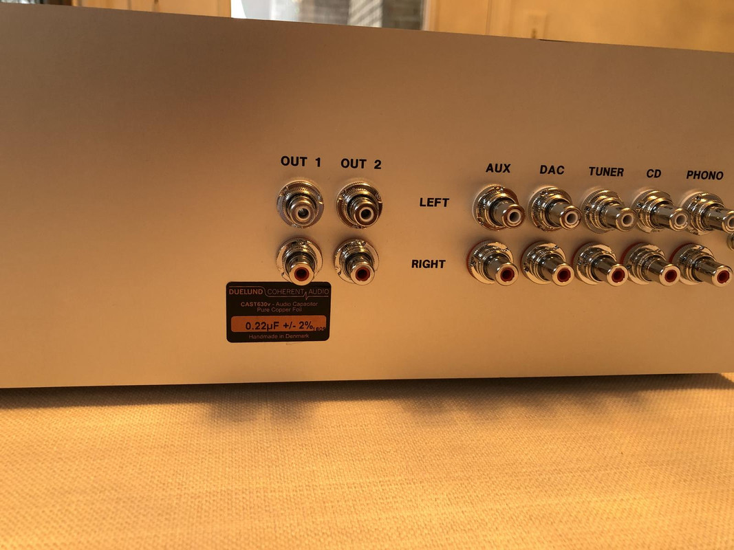

    CMC Copper RCA Female connectors. Had to make the holes 11mm vs the 10mm that comes from Roy.
    Source: Aliexpress

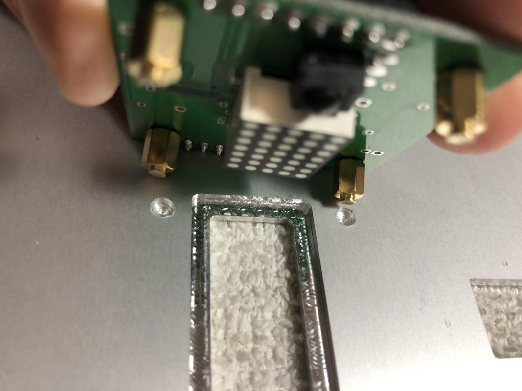

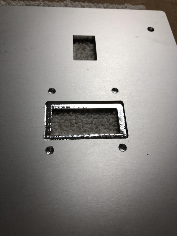

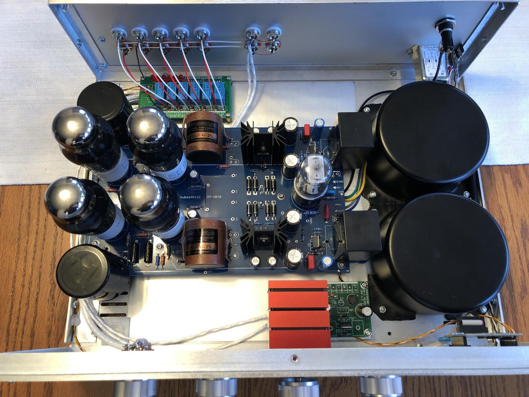

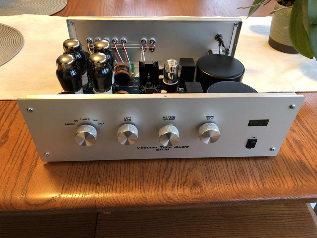

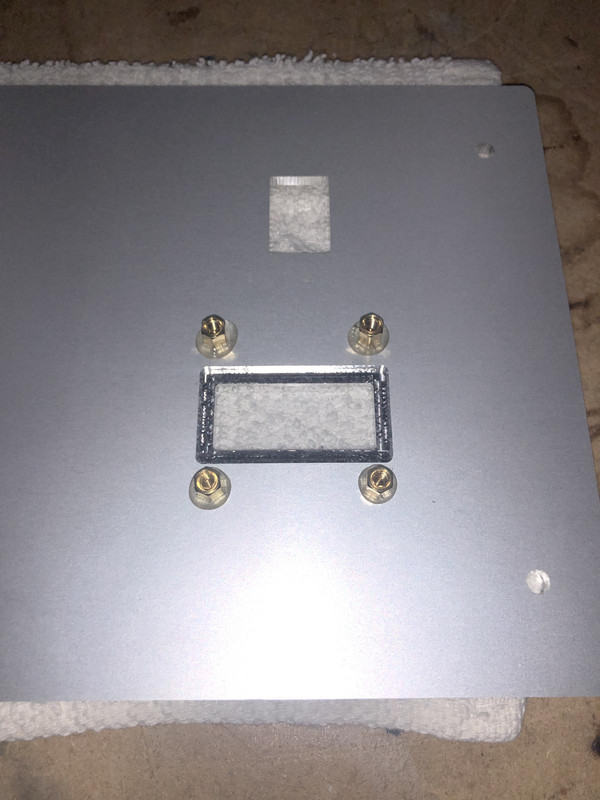

    I did this a while ago but am finally posting photos.
    This is Version 2.0 of my SP14
    I ordered an empty Preamp Chassis from AliExpress, and modified it to hold the SP14.
    Changed the IEC inlet to a filtered, fused, and switched inlet.
    The lid is in the process of being cut to fit around the tubes.
