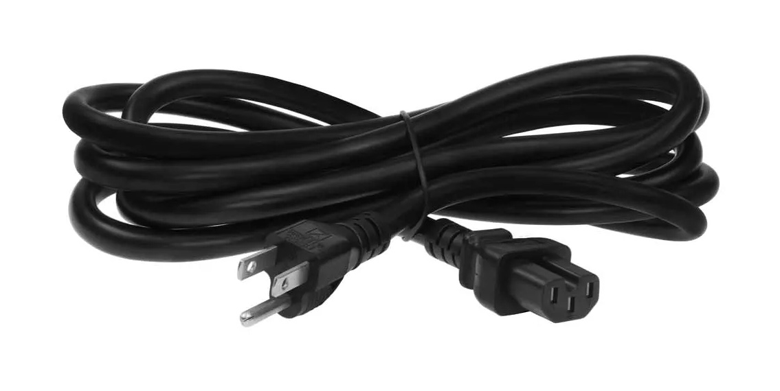

This is a VTA M-125 14 gauge IEC AUDIO power cable. All the wiring inside the amp through the power switch and IEC connector all the way to the power transformer is also 14 gauge wire. 14 gauge wire @ 120 volts is good for 15 amps. I have had a few customers replace this cable that came with their M-125 amps with a fancy cable from who knows where. None of them could quantify any difference in the sound quality of the amps. You won't get anywhere the 15 amp rating of this cable because the fuse blows at anything over a 5 amp current draw. Back in 2010 when I was working with the prototype M-125's, I had an audio friend bring over two "fancy" IEC cables that he was using on two expensive monoblock amps that he had. We swapped the stock M-125 cables with his cables. Neither of us could hear any difference in the sound of the amps. My feeling is that if a power cable can supply enough current to an amp under all playing conditions, you won't really gain anything by swapping out that power cable with another power cable.
That said > I can say that I have heard SUBTLE differences in the sound of an audio system SOMETIMES when interconnect or speaker cables were changed out.
