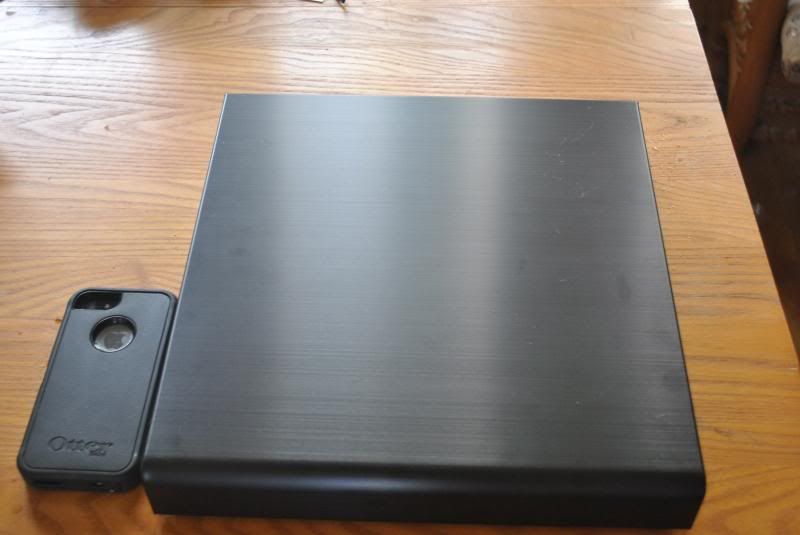

    Lian Li Thin Mini ITX case with the IPhone that is used as remote control for JRivers Media Center on Win8.

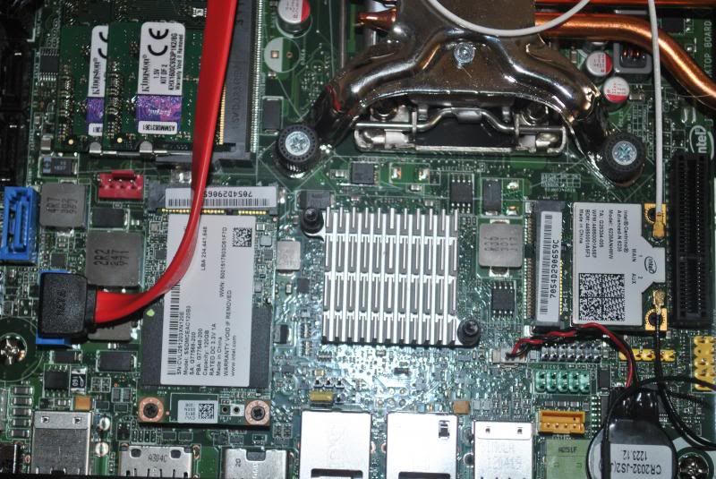

    Inside shot. SSD 120gig drive for OS and programs on the left and a wireless with Bluetooth on the right.

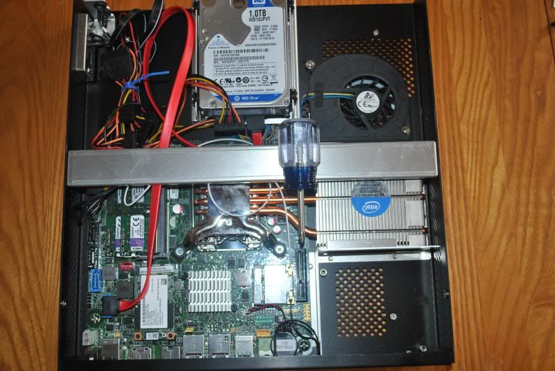

    CPU is an Intel I3 3225 with a low profile heat sink. Music is stored on a 1 TB laptop drive.

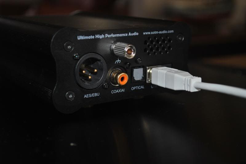

    USB feeds a SOTM dx-usb-hd. It can be run from an external battery source or usb power. If you are using USB power it filters it.
    Music PC Build DSC_1660_zpsff889d91
    Rear shot of the SOTM connections to the DAC.
