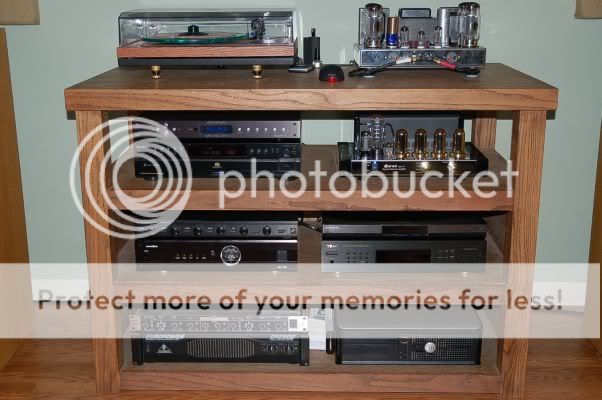

    I would like to move my ST-120 down one shelf space so that it sits next to the preamp. That would put a shelf above it rather than ”looking at the ceiling”.
    I have a low RPM 4.5” thermostatically controlled fan that I can mount in the back of the cabinet. I can orient it such that it either pushes air across the amp or draws air across it and exhausts out the back.
    The reason for this is that I now have a top loading CD player that needs to go on the top shelf along with the turntable.
    Any thoughts? If I do it which way should the fan blow? Front to back or back to front?
    Here's a picture of rack:
    ST-120 and Heat question System7-28-11-2
    It should be noted that the back and sides are completely open.
    THANX!

    Well I tried it last night. Not good.
    While I don't think the amp ran any hotter and the fan did a good job of moving warm air the plywood shelf directly above the amp got VERY hot. Not scorched or smoking but I wouldn't feel comfortable with that arrangement in the long term. Back to the top shelf it goes.
    Time to work on "Plan B". I guess I'll need to track down a low profile turntable or perhaps one with the drawer that slides out. HMMM...

    I used a similar setup a while back and found that after a while the rack itself got heated up because the mass of the wood is able to absorb heat. This led to residual heat being retained by the amp chassis as well because the air had to flow under the amp through the narrow space between the amp and the shelf.
    It also looks like you have little overhead clearance and so the heat from the tubes is heating the top shelf. Those tubes get plenty hot and there is a good possibility that the wood so close above the tubes could get burnt or at least scorched.
    At the very least the tubes will run hotter due to the restricted flow around them.
    My solution was to go to a stainless steel wire type rack that is open below and above and does not restrict the natural convection of air over the amp. There are numerous types and some are very attractive. I found one at Costco for $40.00.
    At $100 approx. a pair for KT'120 output tubes that could shorten the life of the tubes and do some damage to your wallet. I would leave the amp on top. Nice looking rack though but better suited to a sand amp setup.
