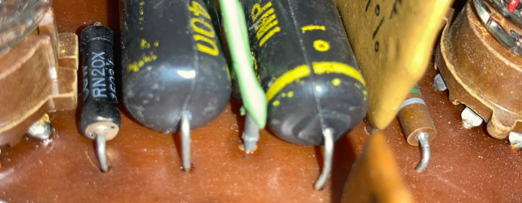

    Post by bubbasweet Wed Jul 28, 2021 11:19 am
    These are them (See bottom of Green wire in photo)

    Post by bubbasweet Wed Jul 28, 2021 11:21 am
    They put a bunch of these in. Good to know they are not stock. I will remove them and solder in. These terminals solder in then the wire is pushed inside hole at top of terminal.

    Post by bubbasweet Wed Jul 28, 2021 11:41 am
    When replacing the PC 5 board with new on the PAS-2 soldered clips Screen10
