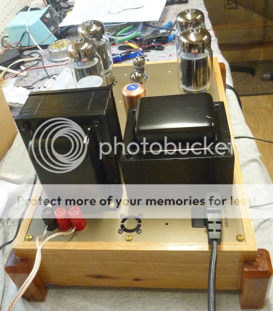

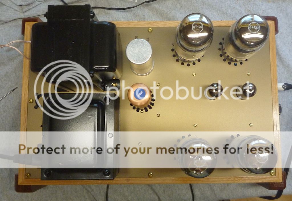

Lovely! I love how you drilled your vent holes with such precision. Now you need a front/side view of the chassis.
I've been thinking of using star or hex bolts to avoid that cluttered look of misaligned screw heads.
I'm also considering placing the speaker ground post in between the 4 ohm and 8 ohm posts. That way, all I have to do is flip the speaker's banana jack 180 degrees to alternate between 4 or 8 ohms.

Tell us more about that little mini-fan. How are you powering it?
Mike
Mike

carpenter wrote:Lovely! I love how you drilled your vent holes with such precision. Now you need a front/side view of the chassis.
I wish I could take credit on the plate drilling....but alas....I cannot, it is all professionally done on a CNC milling machine by Front Panel Express. I could never do such precision work.
I will take the credit for designing the layout though and laying out the vent holes
The front panel too is all done, I am still waiting on the gauges etc., once I have those will take more photo's.
The transformers have been painted and I 'll be able to mount those later today and start on the wiring.
Guest- Guest
- Post n°5
Re: VTA M-125 in custom chassis
mazeeff wrote:Tell us more about that little mini-fan. How are you powering it?
Mike
the ones I use are a mini 12VDC unit, I buy them in bulk from Hong Kong. At full 12V, they are not the quietest, so I have made up a very simple variable DC power supply using an LM317 regulator, in a TO220 package, and drive them at about 8VDC, I found at that setting they are very quiet and still move plenty of air. Being a variable power supply, I can fine adjust that fan supply voltage to arrive at the best/least 'noise setting'.
I use a mini fully encapsulated transformer for the 15VAC supply, that same transformer also supplies the VU meter driver board.
I am using the fans to push air into the chassis. Hot tubes, by the nature of heat, draw air 'out' of a chassis through vent holes, that small fan supplies cooler ambient air into the chassis to aid in the tube cooling.

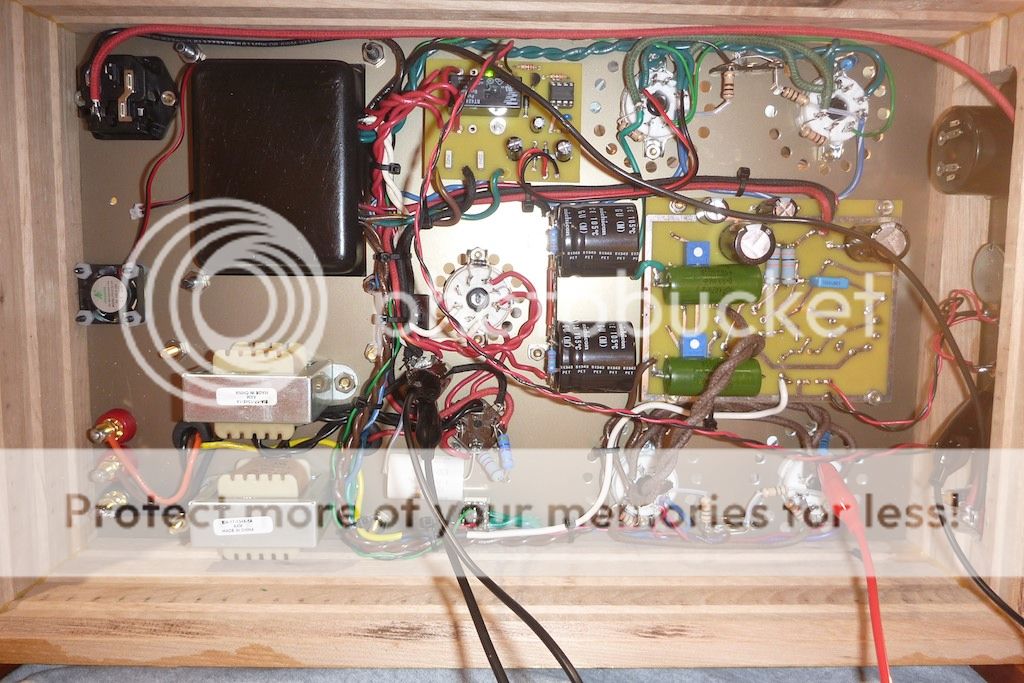

Is that the "soft start" board I see in there?
Guest- Guest
- Post n°9
audiobill wrote:Is that the "soft start" board I see in there?
it is indeed, I believe that is a great addition to any tube amp in extending power tube life, and the extra cost is minimal

well, the beasty is alive...and sounds just so wonderful!...I had the volume pot wired the wrong way, nearly blew the test speakers off the wall!!!!!!!...not to mention my eardrums!!
Powere straight up, no worries.
The wiring is still somewhat temp, I am waiting for the correct handed front panel, the one in the photo is for a 'left handed' chassis, the amp in the photo is actually a 'right handed' chassis.

On a side note, would there be an improvement if you clocked one of the chokes 90 degrees?

colin86325 wrote:She's a beauty!
The chokes are mainly passing DC .. They are there to "choke off" small amounts of AC riding on the DC before the audio signal is dropped onto the DC B+. Because almost no AC is passing through the choke, there is virtually no interaction either between the two chokes or between the chokes and the power transformer.
Guest- Guest
- Post n°13
Bob Latino wrote:colin86325 wrote:She's a beauty!
you took the words right out of my mouth! :-)
