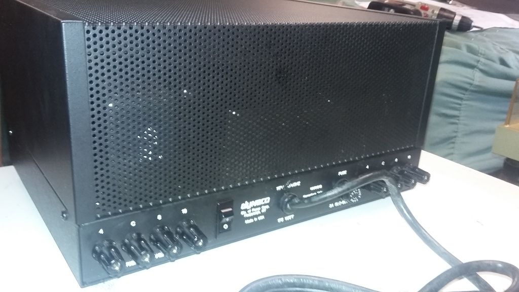

    I have one of these series 2 models that was found in a warehouse, looked to be unused, and has some odd features.
    1st there is no series 2 label on the chassis
    2nd binding posts are all black
    3rd capacitors are black, most pictures I find online they are blue
    4th circuit board cover on had two screws out of eight, no other holes showed any sign that there was ever a screw there
    This amp had mildew on it all over, including the tubes. I'm thinking it was a first run of the series 2, maybe put together for testing purposes but forgotten about. When I powered it up slowly on the variac I could smell the fresh paint on the tubes burning, no sign that this amp was ever used. The cord appeared to have the original zip tie on it, and there isn't a scratch anywhere on this amp.
    Anybody with more knowledge of this model please chime in.

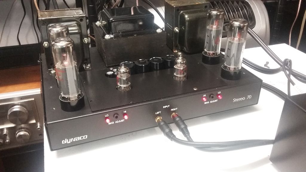

    Here is the top with the panel removed.
    [img][/img]

    100 ohm screen stability resistors
    Post by supersportsteve on Thu May 12, 2016 9:28 pm
    This addition will eliminate tube arc and resistors blowing, two pin 4's were feeding capacitors so jumpers were added and theirs traces interrupted. I am told the addition of the more modern power supply and extra capacitance can cause havoc, this should help the tubes last longer.
    [img][/img]
    DynakitParts
    Posts : 189
    Dynaco Stereo 70
    Post by DynakitParts on Thu May 12, 2016 9:53 pm
    Hi,
        What you have is a early version of the Panor ST-70 Series II that was first produced by Sound Values of Ohio. Sound Values & Panor eventually parted ways at which point most of the parts were made & assembled in Asia. All of the parts such as the circuit board, transformers and metal work on your unit were actually made here in the USA. As you say...this may be one of the first production units produced by Sound Values.
    It appears to be in nice condition...Enjoy!
    Kevin @ Dynakit

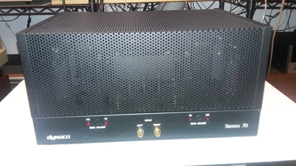

    Thanks for the information Kevin, it is very much like having a brand new amp, and I'm very happy to have it in my Dynaco collection. list below... Cool
    I'm very impressed with its sound since putting my winged Svetlana tubes in it, looks like one of the original tubes is very poor or defective, causing it to sound very thin.
    This all black amp should look right at home next to my sweet MK-II's done in black.
    ST-70
    ST-70 II
    MK-II (4)
    MK-III (4)
    SCA-35
    SCA-80Q
    PAS-3X
    PAS-3
    [img][/img]

    Since I have both, a very nice original example of the ST-70, and this series 2 version, my review is unbiased and without $ involved. Wink lol!
    My ears tell me the series 2 has better bass, but highs are slightly rolled off a bit. Since I have them paired with horns, I think the original ST-70 is a bit bright anyway when playing CD's.
    Having read and talked to a few series 2 owners that had cathode bias resistors fail pretty often, I feel adding screen stability resistors will eliminate this problem. Dave Gillespie's writings on this subject points to the more modern power supplies causing the tube arcing, and resistor failures.
    My opinion on this series 2 is that it probably was never sold, and was either pulled out of line because of a blemish, or maybe for testing. The fact that it does not have a series two logo, or serial number on it anywhere, makes me think it might of been from the very first prototypes. A production unit put out for sale would of had a serial number, and the series 2 on the chassis. A bit of a mystery, but I'm happy to own a part of the Dynaco (Panor) history.
    Although it's not anything over the top special, just having what could be a factory prototype, or NOS early series 2 Stereo 70 has a bit of coolness to it.
