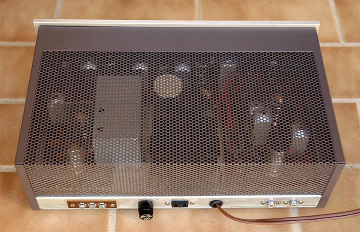

GP49 brings out a good point about sealing any polishing on any PAS faceplate. The clear coat will protect against scratches and seal in your polish job. You should also seal with a clear coat any repainted Dynaco outer cases or tube cages.
A good tip for repainting Dynaco outer cases and tube cages is to first sand out the scratches and repaint with Krylon #4292 which is their brown camouflage paint. The only catch with this paint, whose color is very close to the original "Dynaco brown", is that the finish is ultra-flat. After the paint dries you then clear coat with any "satin" or low gloss finish. I like the Minwax Clear Satin polyurethane clear coat in a spray can. The satin finish is a low gloss clear coat finish and the combined result looks very close to the original Dynaco brown. Both the Krylon #4292 and the Minwax Clear satin are available at most Wal-Marts.
The outer case of the Dynaco FM-3 tuner in the photo below was painted as described above.
