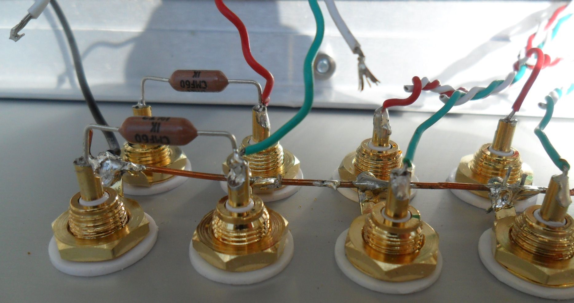

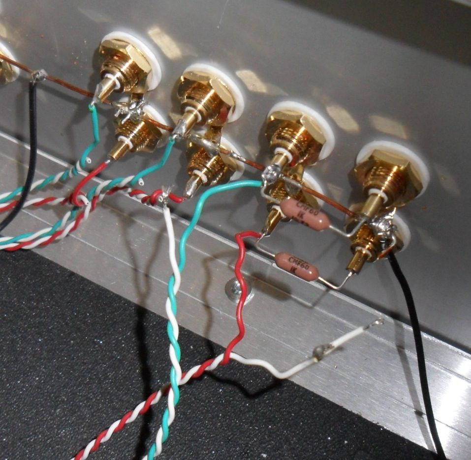

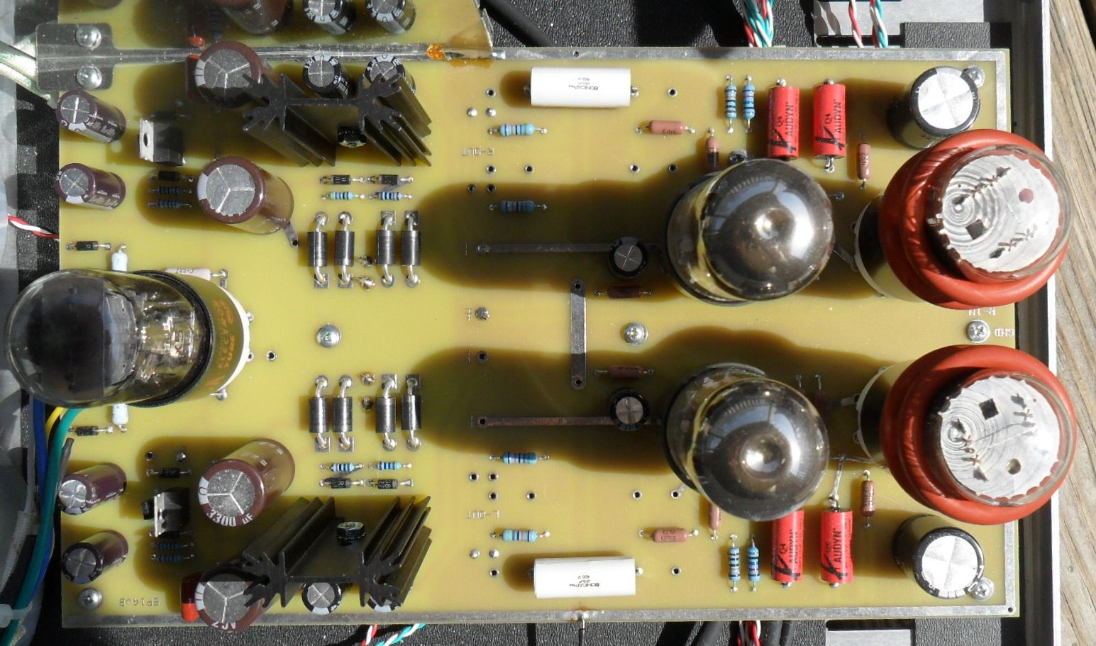

More questions. Thanks for bearing with me...
I opened up the SP 14 so I could install the NOS GE 6SN7's in the critical spot (as per Kently) and I noticed that many of the white wires were clipped. I'll post a few pics.
My guess is that these are grounds and as the outputs are grounded to the AC line and the board (see black wire) already, it was discovered that these many grounds were causing a loop and were deemed redundant and clipped. Pics....
Many of the white wires going to the front panel pots were also clipped but (mostly) shrink tubed at the connection.
Also, do you see any thing on the board that maybe should/could be upgraded? I think those white caps say "Sonicaps".
Thanks for continuing to help out on this project.

- Post n°34
Re: Just bought an SP14 and PH14
https://mikeriversaudio.files.wordpress.com/2010/10/grounds_and_shields_revised1.pdf
This is "one-end-only shielding". It is intentional.

way back to post 33 in this thread (I'm on vacation so a few days delay) yes, as Kentley pointed out, the grounds are connected on one end only, otherwise you've have a dozen++ ground loops in the preamp causing all kinds of problems and noise.
As for upgrades, the SoniCaps are very good, but Mundorf EVO silver oil (about $25 a pair) or best Mundorf silver oils (around $90 a pair)
would make a significant improvement in sound quality.
Also, many people do have cheap CD or cheap DAC sources that don't have an output buffer.
Within the next week or two I'll have tube output buffers available as a separate product,
also JFET output buffers which will be high quality but at a MUCH lower price level than possible with tubes.
